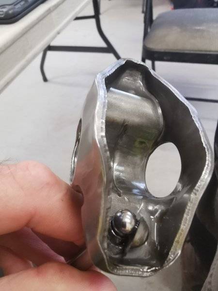

Punched another pushrod through a stamped steel rocker last Sunday. That's two in two years. Was looking at these:

It's a cruiser, not a race car, but one of these days I'm worried I'm going to do more damage than just ruining a rocker and pushrod. Any thoughts appreciated. Also looked at Harland Sharp, but am waiting for an email back from them to see if they can fit these heads. Hughes advertises they will. Also, I assume no reason to go 1.6 from stock 1.5 for my purposes. As always guys, thanks.

Geez what kind of seat pressure are you running because your cam lift isn't that crazy? Was it the same one that went south?
2 years ago, it was #4 cylinder exhaust valve. Last week it was #7 cylinder intake valve. Waiting for the engine builder to call me back now that I've discovered the problem.

Were the rockers in good shape? Note that on stock rockers the metal surface where the rocker touches the pushrod is hardened, but the rocker is not hardened all the way through. Even a little bit of wear here means that the rocker will wear quickly and cause you grief. Could that have been an issue?
It's spilled milk now since you have ordered a new set of rockers. But it might be good to check your old ones carefully.
