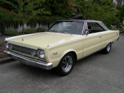

This is not my car, but the colour combo I had on my first 66 satellite many moons ago, loved the cream yellow and black vinyl roof...
