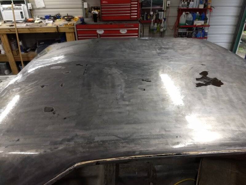

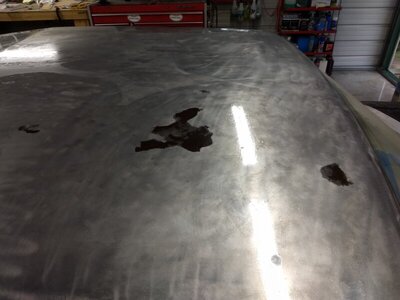

Hey guys...just finished stripping the roof on my 65 Belvedere... its in great shape except for some pitted spots... one pretty good size.(see pictures)... the inside of the roof is clean in the same spots... so its all external. any of you guys with more restoration and body experience than me ( probably most of you) have any suggestions... short of replacing roof?... also is it typical for the front 2/3 of the roof to be a little "oil canny" on these early bbodies?... or is that another issue I need to deal with?... any help is greatly appreciated!

Was that a vinyl roof? It looks fine for doing any sheet metal repairs it might need. If mine looked that good I certainly would not have replaced it.

no..not a vinyl top...I wonder if it might have spent some time in the hot sun somewhere...

...With a tarp on it. That's what I had on my car. Someone had used a tarp on it at one time and placed something like a five gallon bucket on it. Only had pitting in that area.
The pitting should be sand blasted if possible and then you could use a epoxy primer. Then a skim coat of filler over the pitting. Maybe even a sandable filler primer could be used in place of a filler with several coats.
A rust encapsulator could be used over what you have there without sand blasting, then a sealer/primer. If there isn't any adhesion in the pits because of corrosion it could cause problems during painting or later on they could start popping through the cured paint. I'm not up to date on what's available out there anymore. Might be something else.
Why does the metal look wet? Wax and grease remover?
Do what @khryslerkid says. Clean, epoxy, fill. I would use a high build primer and block. I’ve also had good success with a ZChrome product called Rust Defender.
I had an issue like that on my ot 54' under the belt line trim. I used that rust converter stuff that turns it black but it didn't sit well with me for some reason. I grabbed a cheapo hand held spot blaster from Harbor Freight and some clean ,dry sand. I did the couple of spots i had, and felt much,much better about it. The whole car was being done so it was hit with epoxy primer, not problems what so ever.Glad i took the extra time it was cheap insurance. Also i used Evercoat Metal glaze on the pin hole areas to fill.
I had just washed it down with an acid wash.

I just did a truck where there was zero paint left on it but was really solid, I sanded it all down then treated it with a 2 step SEM treatment then epoxy. For that small of area's I'd sandblast them carefully with minimal pressure taking care not to warp it.
