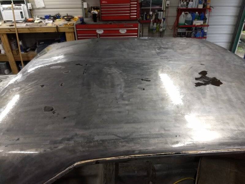

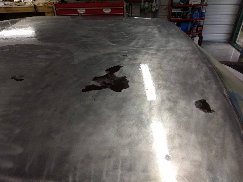

You could try soaking a few rags in Evapo-Rust and laying them over the spots, then cover that with a heavy plastic sheet or wrap to keep it wet. Check on it after a night and see how it looks.
was it a vinyl top car?i have seen this type of damage on them , from the factory they never painted the roof just primer then the top over the primer the top is porous & lets water in /under the top have a GOOD metal body man cut out the bad & weld in new steel then prime it & top coat it or at least clear the primer that will stop itHey guys...just finished stripping the roof on my 65 Belvedere... its in great shape except for some pitted spots... one pretty good size.(see pictures)... the inside of the roof is clean in the same spots... so its all external. any of you guys with more restoration and body experience than me ( probably most of you) have any suggestions... short of replacing roof?... also is it typical for the front 2/3 of the roof to be a little "oil canny" on these early bbodies?... or is that another issue I need to deal with?... any help is greatly appreciated!
