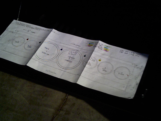

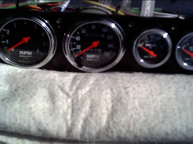

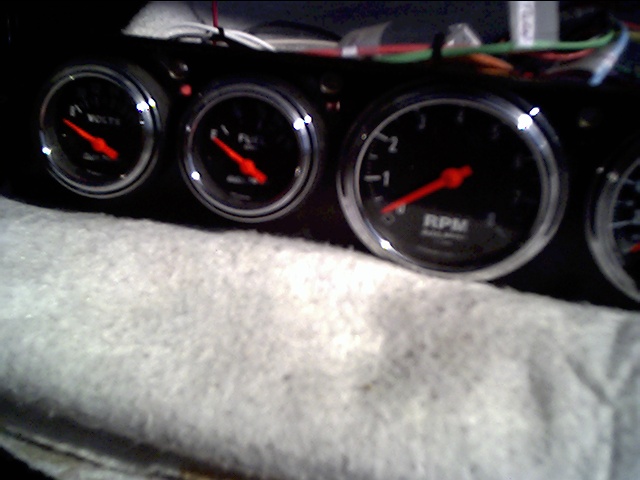

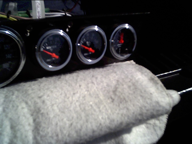

Aftermarket Gauges= Here are the ones I did for my 68 RR HT {Below, still not finished}, all Autometer, 3-3/8" tach & speedo, 2-5/8" oil press., clock, water temp., fuel level, voltage meter, in pods angled up & in, with all with custom 0.090" aluminum gauge panel... I would also suggest to buy a engine bay harness with a Electronic Ignition already wired in so it, more plug & play kind of, from M&H Harnesses exclusively sold by Year One, it helps to cleans up the engine bay a ton, also maybe go to a Holley style carburetor & K&N Xtreme airfilter & a drop base for {Holley HP, Quickfuel, ProMaxx, Proform etc.}, instead of the Edelbrock/Carter, much better carburetors to tune & have performance & drive-ability, IMHO, but biased opinion anyway, also have the vacuum advance & an electronic voltage regulator, hooked up too, instead of the analog style regulator... Depending on what gear ratio is in the rear, you may want to go a little higher gear ratio lower #'s, a 3.73:1 {or 3.55:1} is a great compromise, for performance & street driving, but still very manageable on the freeway... All easy fixes, I'm on #13 68-71 RR now, I love them, many parts from the 68's will work on the 69's also, there were minor changes, mostly cosmetic stuff, grill, taillights & surrounds, marker lites, seat marerials, minor trim, etc...
