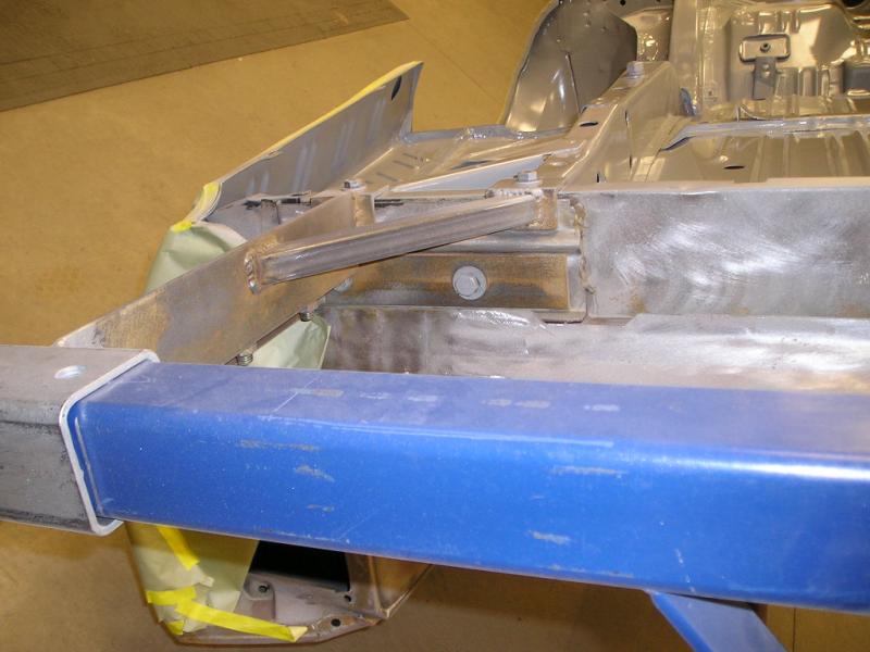

Where oh where do I bolt up the front of my 67 Coronet? with the bumper off and the brackets off? thanks. Gee now that I see this in print it looks like a stupid question...lol.
Yah I see it now that I have the bumper off. Duh. Need an angle bracket on both sides.

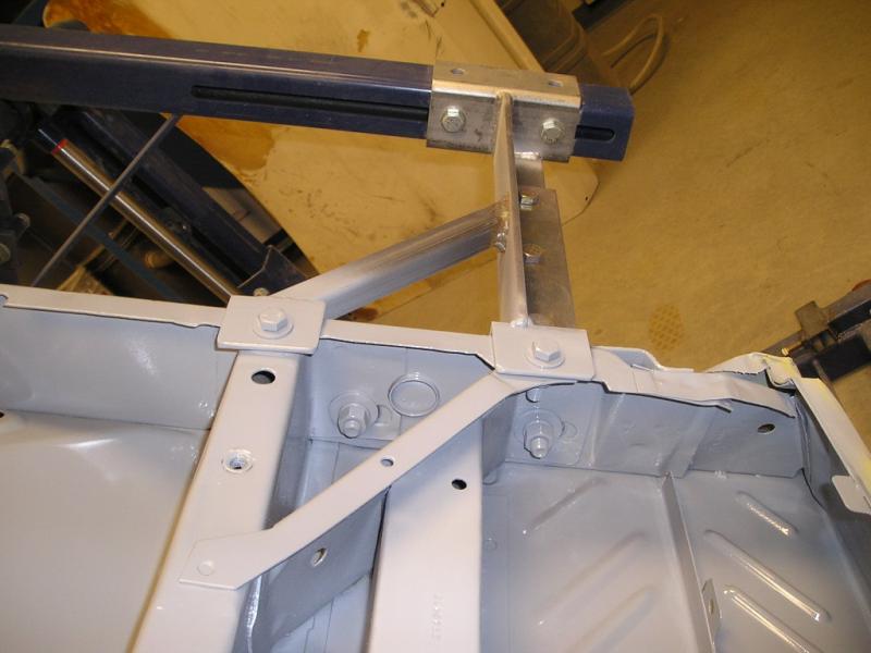

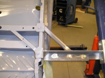

Here are a few shots of the brackets I made for mine. This the rear and yes, it's upside down.
