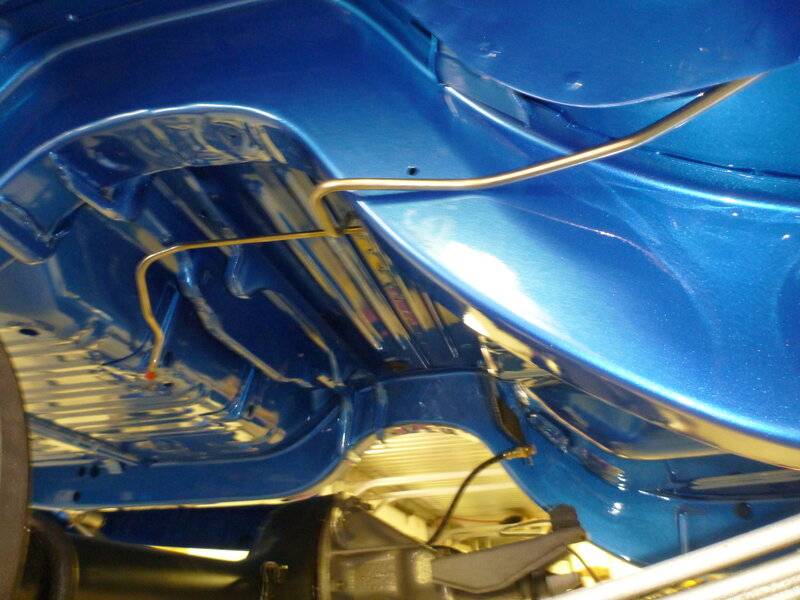

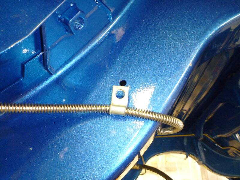

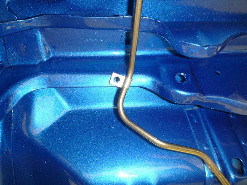

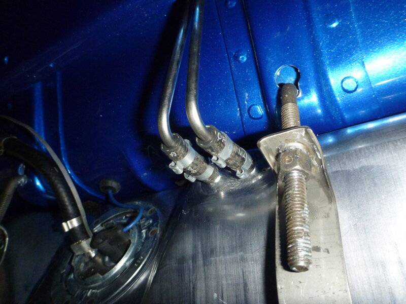

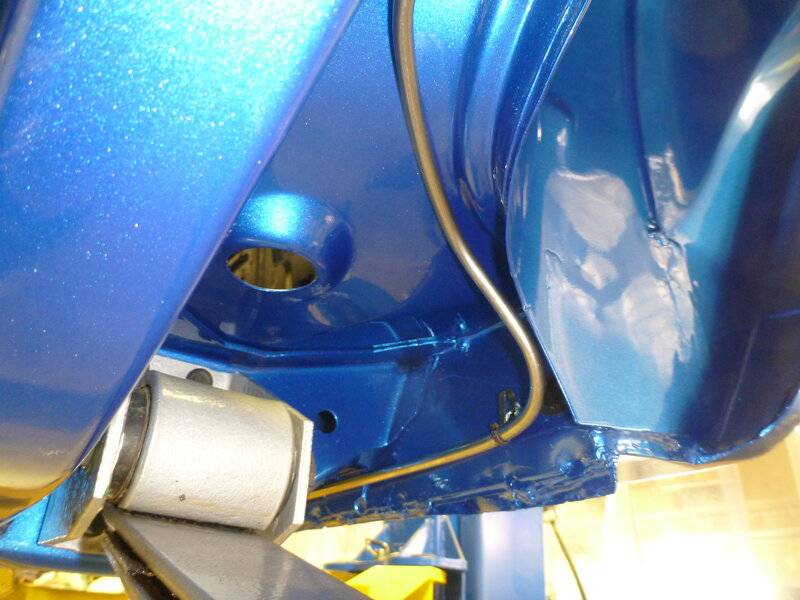

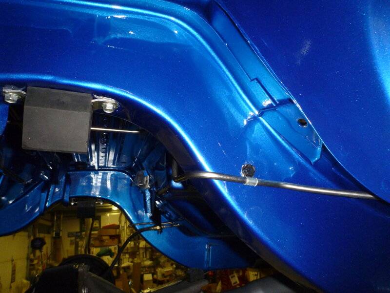

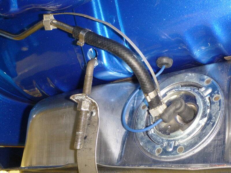

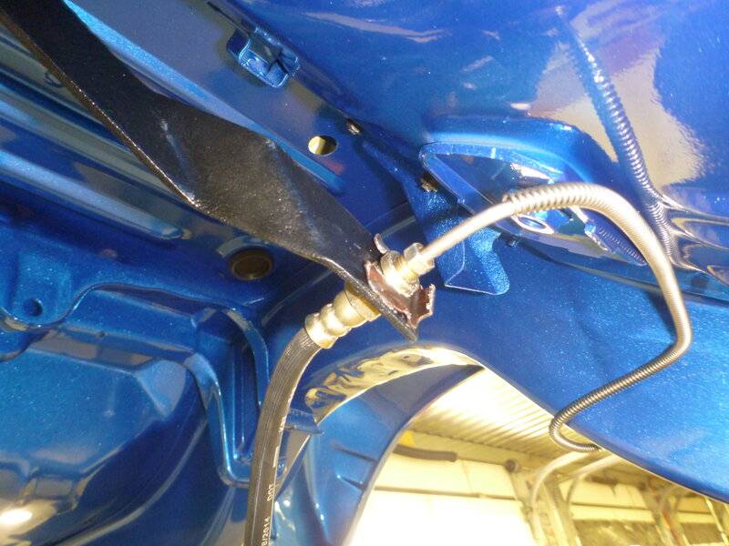

Anyone have pics on how to route the steel lines in the rear of a 68 roadrunner? Tried to tackle it today, I know it's probably something simple I'm overlooking.
Are you making your own? Better idea, buy pre-bent lines. Can get them in stainless or mild steel, takes all the guess work out of it, order the clip package with it. You won't regret it.
