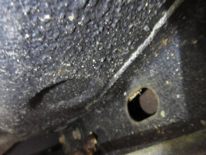

I’m thinking about adding a return line to my 68 Coronet. Looking at the bottom of the car. Where is the second line routed? The hole in the torsion support seems only big enough for 1 line. Can anyone shed some light on ths for me? Maybe a pic or 2. Thanks.

Does it share the same hole in the torsion support?
Yes. I don't have either of my lines in ATM but I recall them both going through the same hole. I'll have to check but I believe it's an easy fit.
You may have this figured out by now, but here's a pic of the hole the fuel and EGR lines went through in 72.
Thanks guys I got it figured out now.
