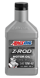

I’ve wondered about Amsoil since it’s sold through MLM, like AMway.
