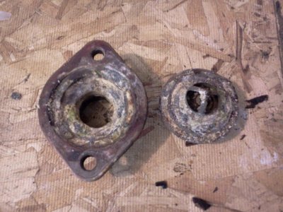

Well, I did some work and got the bolt out that I busted off, and looky what I found. I'm guessing that the radiator is totally clogged up inside. Can they be cleared out or do I need a new one?

I got it, it's a 4 core that had been re-cored already. I took it to a shop so they could do some serious flushing on it. Hopefully with the shroud and the clean-out, It should work properly.
My god Daryn......Looks like something that was salvaged off the Titanic.
I'm sure that will make one heck of a difference getting that garbage out of your radiator
Yeah, it was pretty bad. came off in 1/4 inch thick chunks. I took the radiator out and brought it to a rad shop so they could do a pressure flush on it. Had it over the weekend, went back to pick it up and they never looked at it. That did it, I took it home and flushed it myself with a garden hose. Filled it part way, picked it up and did the big shake with it several times until the water came out clean. I decided that I'm tired of waiting for other peoples schedules and decided to pick up some tools and do more of the work myself.
