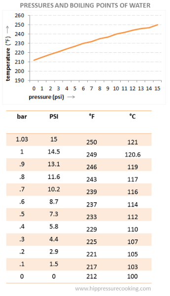

If let's say the old cap wasn't building up proper pressure, does the pressure help the cooling ability?
The pressure increases the boiling point of the coolant. If you have an air bubble, or pocket, it cannot absorb the heat as the liquid can. By pressurizing and increasing the boiling point, it maintains the coolant in a liquid state to enable absorption of heat generated from the cylinders.
Atmosphere at sea level is 14.7, graphs are above atmosphere. So a 12 pound cap is good to prevent boiling up to about 240 degrees without coolant.
Important point of pressure at sea level. Atmospheric pressure decreases as altitude increases.

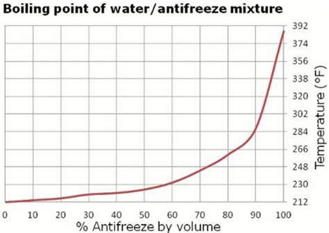

Interesting thread! Out of all of the cars I owned, I always had them running on the higher end of 180. Just had my 400 rebuilt and when it is hot and humid, it runs on the lower range of 180/185 and can get up to 220 if sitting in traffic. With all this being said, what temp is when you have to let them cool off? Based on the graph above is it 240?
Here’s what I have understood about thermostats: in cold climates a higher temp stat is desired as it heats up the coolant in the block before it releases coolant to the block from the radiator. Faster heat means more window defrosting and cabin heat sooner. Being in a cold climate, there are winter days when it can’t happen soon enough. It has little effect on operating temperature. It will be the same, though with a lower stat it may take a couple minutes longer to reach it since the changeover from the radiator occurs at a lower temp. Debates on a 160 vs 180, IMO doesn’t mean much. I run a 160 as my ride is only driven in summer and hibernates in a heated garage. I run a 70/30 anti-freeze mix, debatable, but I’ve read that anti-freeze retains heat more than water. Another tidbit, debatable? Not running a stat at all. I’ve been told that the stat does inhibit some flow and is beneficial by design for the radiator to have more time to do what it’s intended...cool the coolant running through it.
That temp is without coolant. Get you an antifreeze tester to know for sure what the temp will be. That temp is also where it starts to boil and not effective. But that being said if you had enough antifreeze in it to keep it from boiling to 350 F , I don’t think you would want to run it that hot because you would start wiping bearings. Get you an antifreeze tester, and you will know exactly what protection you have,
