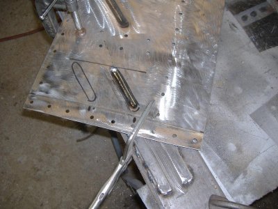

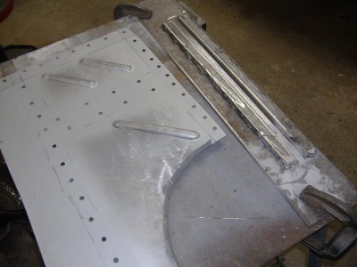

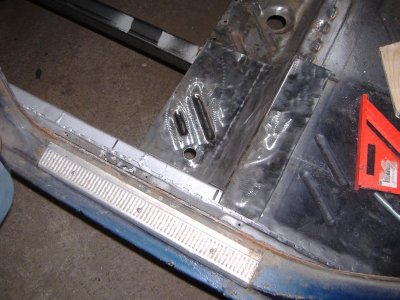

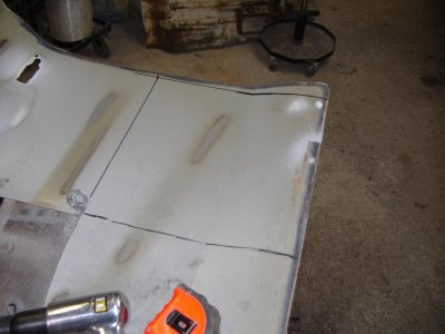

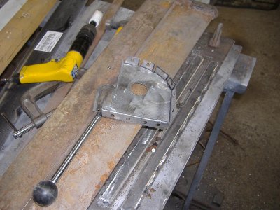

Decided to take a break from "structure" and fill in a few gaps in the floor pan.
A change is as good as a rest! LoL

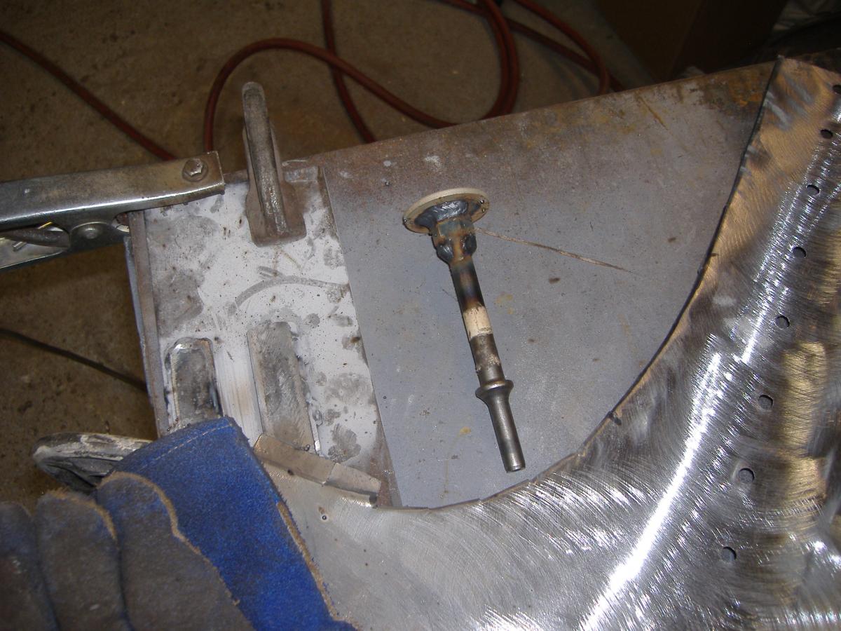

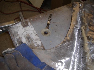

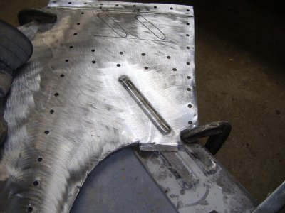

I made a little tool for my air chisel from a broken chisel, an acorn lugnut and a heavy washer.
Made a channel from steel bits for it to run along in and next thing I could make reasonable beads to get the recycled metal floors to look kinda right.
Got the idea from an old thread over on the HAMB Hot Rod board and used what I had lying around to make it work for me.
Kinda caveman...but its really noisy to use so its perfect! :D
I started on the rear underseat pans.

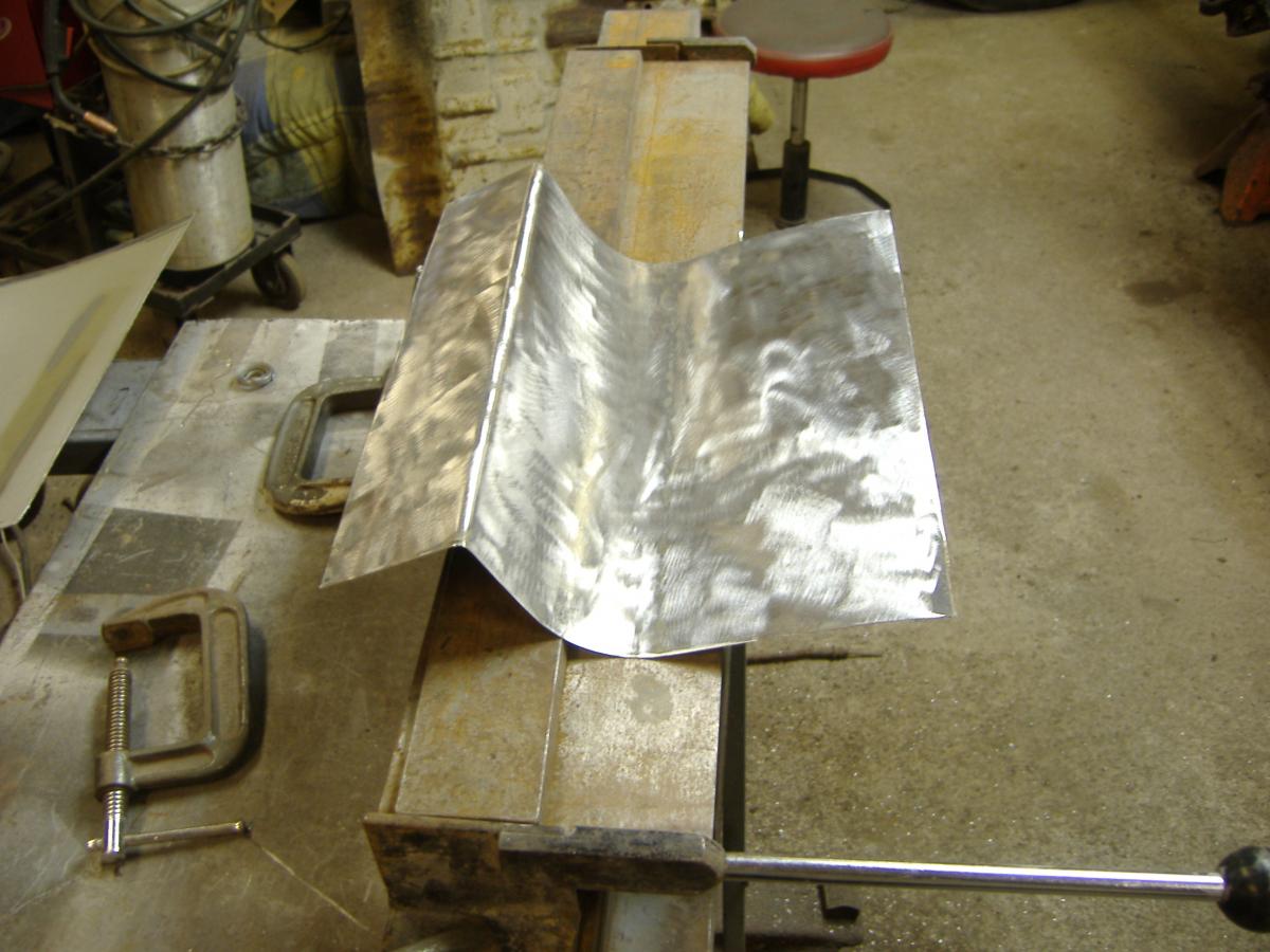

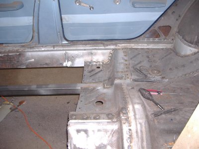

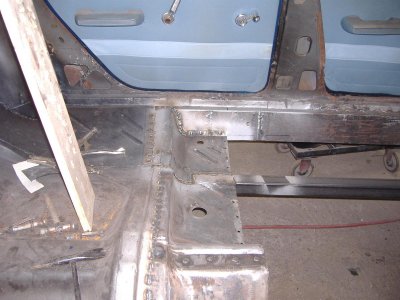

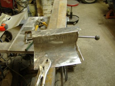

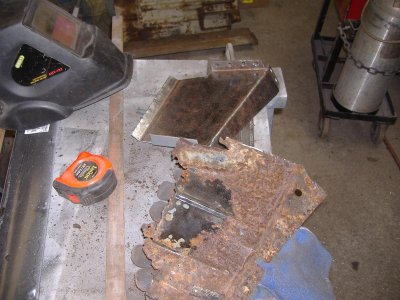

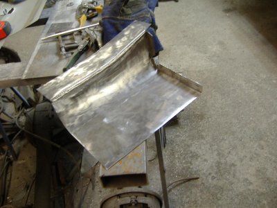

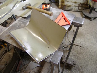

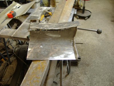

Carried on then by making the sections that meet up with the main forward floorpan.
The center hump piece is from the donor 67 Belvedere floorpan I got for free from a friend. Just had to clean it up to make that work! ;)

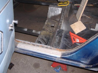

nice progress on your work. just a question,all the reenforcement that you welded on,has that added any more weight(if any) or not enuf to make a diiffernce?
Don't think I've added much extra weight, but if I did its all in good places! :)
The 2x2 subframe connectors have added a bit for sure...but the torsion bar reinforcement stuff is minor compared to the peace of mind. The 2x4 tube is replacing the factory spring mounts in those areas and I'll be losing the rear spring mount pieces as the shackles now go thru the frame.

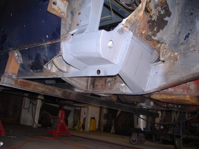

The rocker panels were cut out before the new metal went in...
It was heavier than normal anyway just before I started to rebuild it as the floors were all double/triple paneled and tarred.
The guy just left the rusty stuff in place!

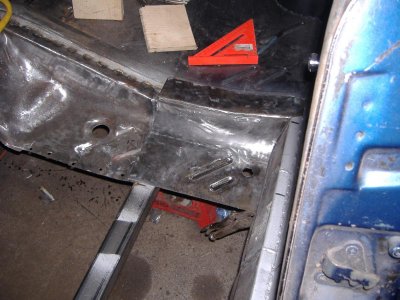

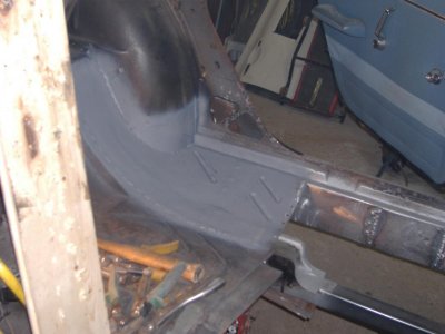

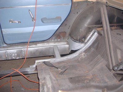

Here are the pieces welded in!
Forgot to put those pics in the last update.

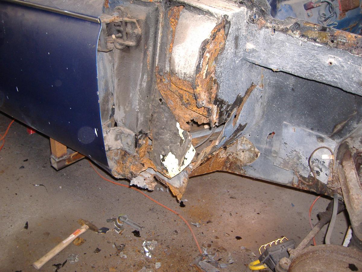

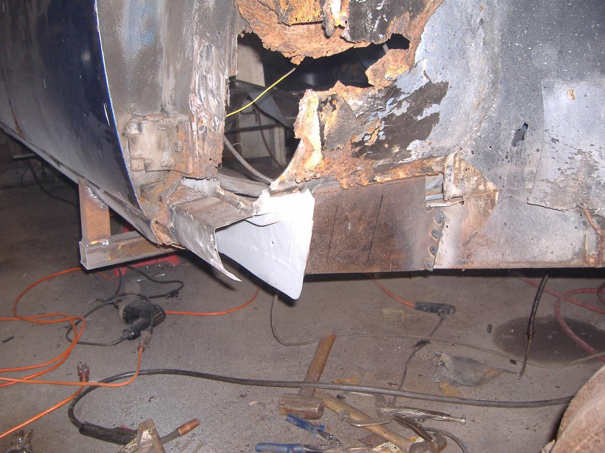

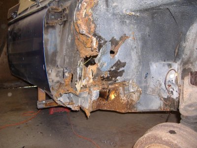

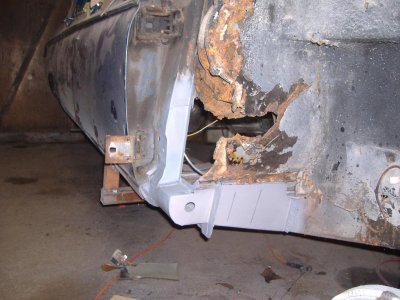

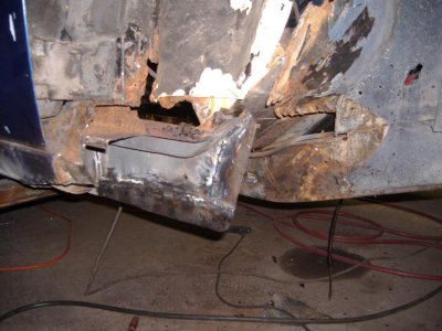

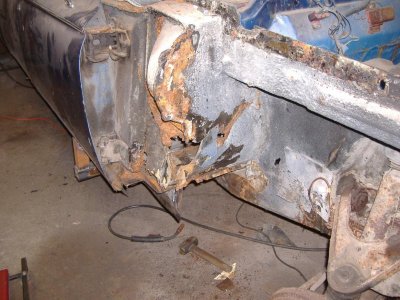

The right front corner of the rocker and cowl was smothered in hardened tar so I knew it couldn't be good.
When I removed it most of the body in that area seemed to come with it!
The yellow piece you can see was a piece of vinyl siding that someone had riveted in place and covered with tar! Quality thru and thru!!!

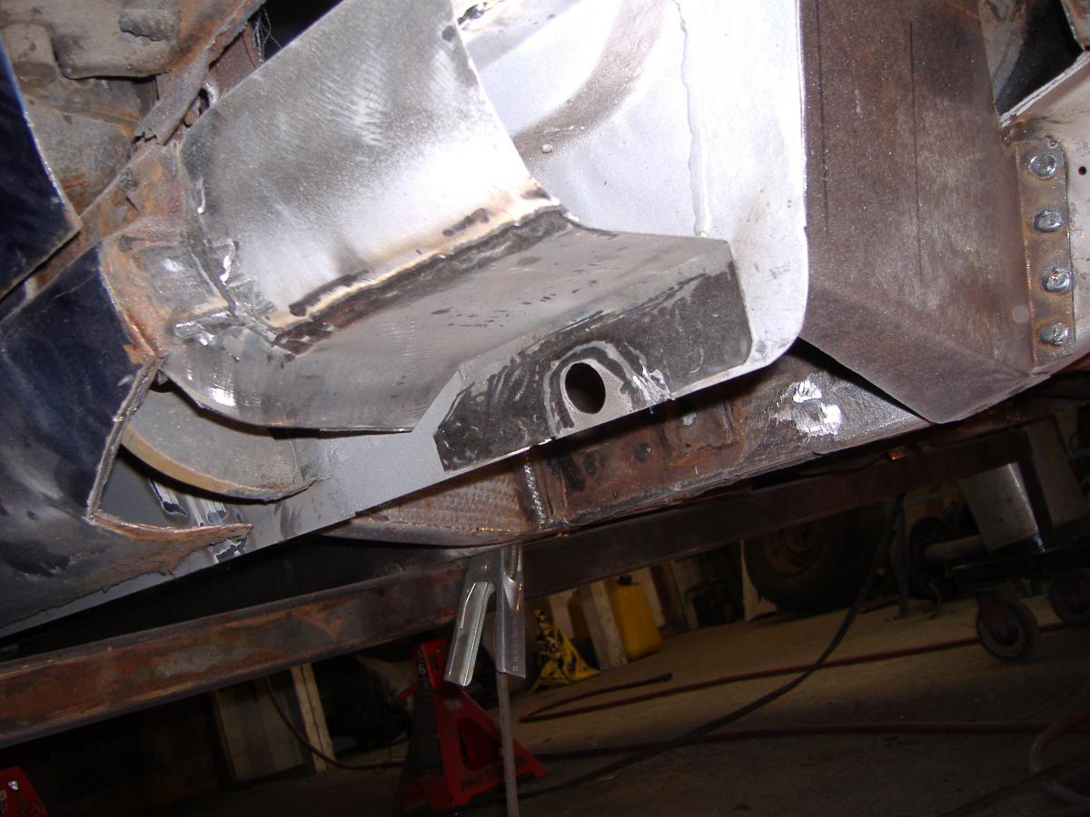

Fixed up the inner rocker edge and then replaced the chassis support as it was really weak.
The car is supported by jackstands and additional screwjacks at this point to prevent sagging.

Added the bottom and side pieces to the rocker front.
Capped off the front.
The door post was getting weak as well so I repaired the front section and will do the rear part once I take the door off.
Feels a lot better to have that area done I tell ya! That was a mess....
