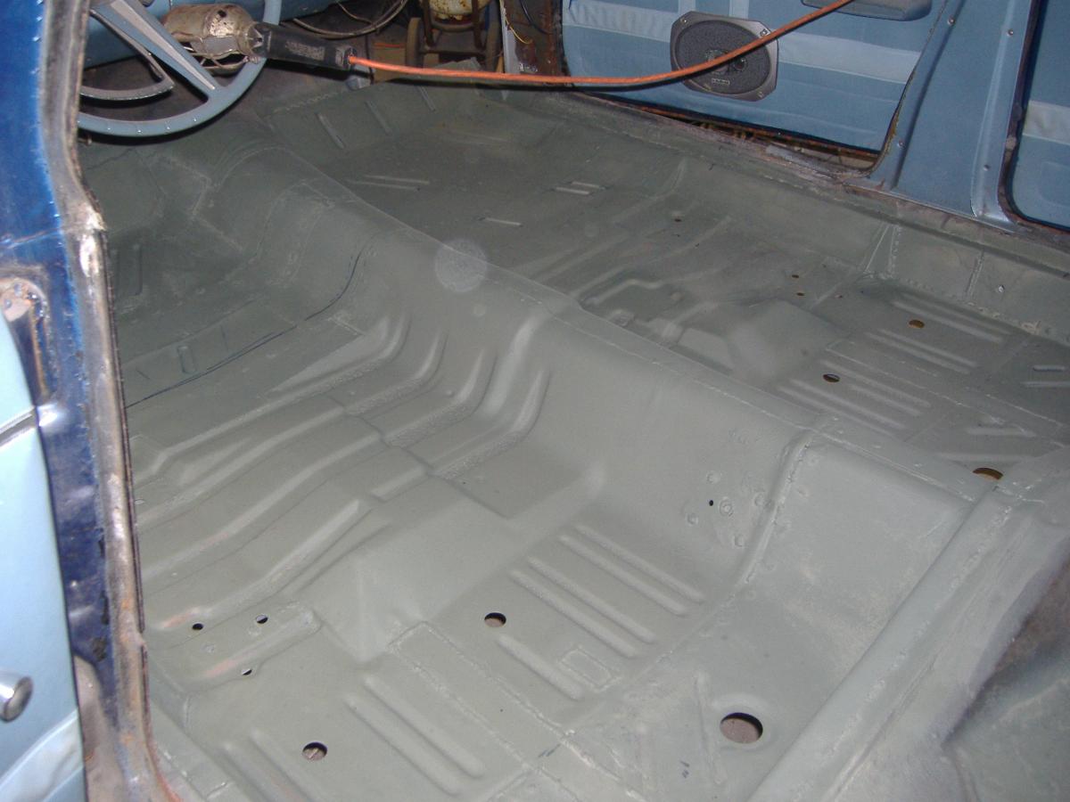

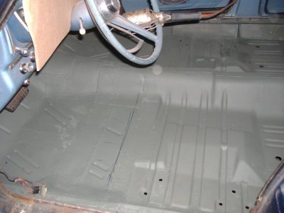

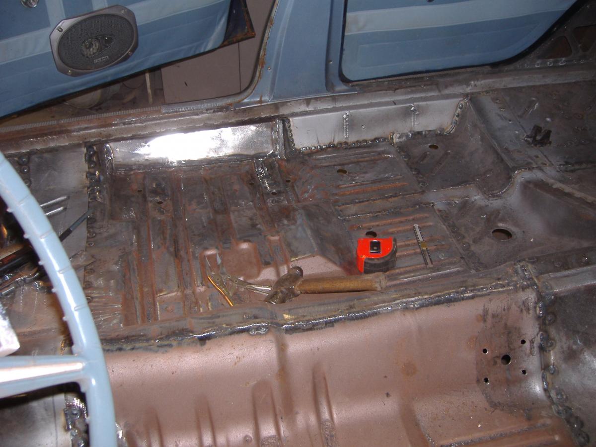

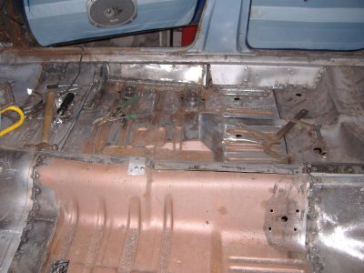

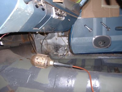

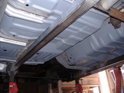

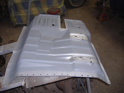

The pass floor area was basicly a repeat of the drivers side, with the donor floor section needing repairs before being installed.
Sure is nice to look in a window and NOT see concrete below!!! :)

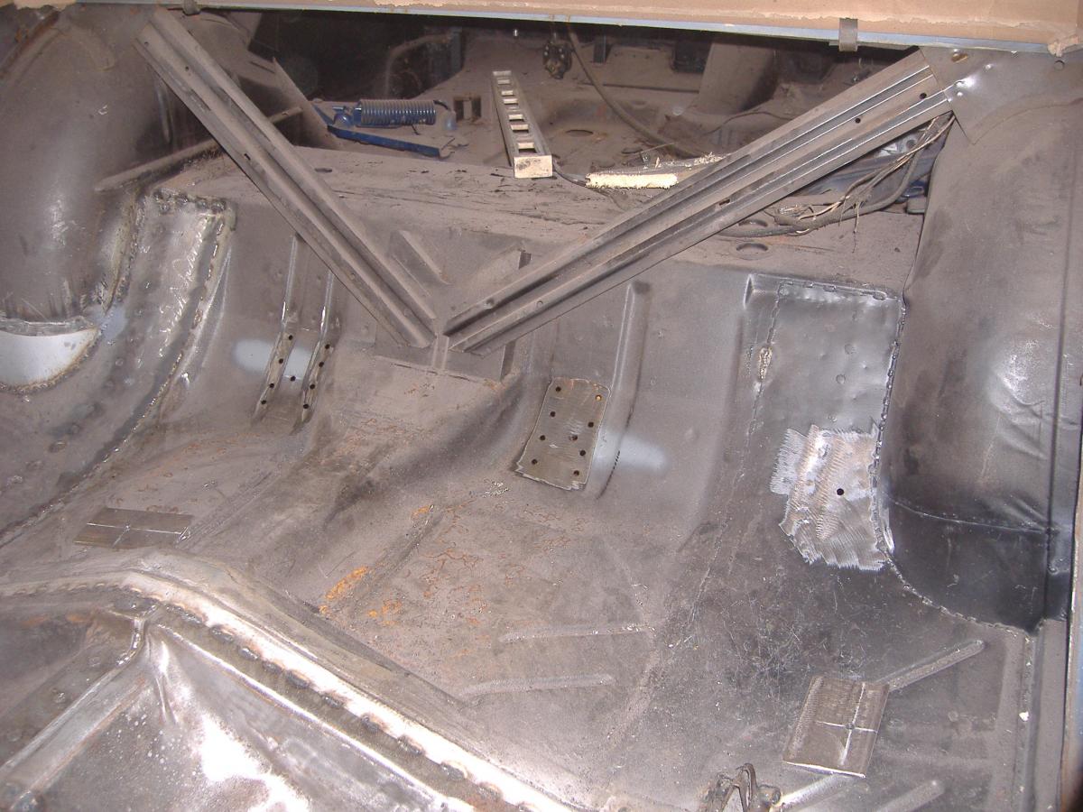

Also finalized the locations for rear seat belts and got ready to add the plates under the floor.

Would you mind showing where you are going to locate the seat belts for the rear? I need to do the same for the grand kids.

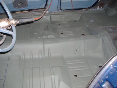

Cleaned up, etch primed and ready for sealer. :)
Joe, I just looked at some pictures of later B bodies to get a general idea on where they went and then I put the lower rear seat in place to get a guide on the height.
I THINK my locations will work fine but I can't make a recommendation on the exact location to put them.
I will say that you should use large plates under the floor and if possible weld them into place...although your car may be finished and welding not an easy option.
Whatever you chose to do, make sure to have it strong as the people those belts are holding are not replaceable!!! ;) :D

Yes ok. I will install some extra plates but will probably bolt them through floor cause at this point like you point out I really don't want to weld.

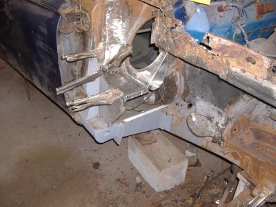

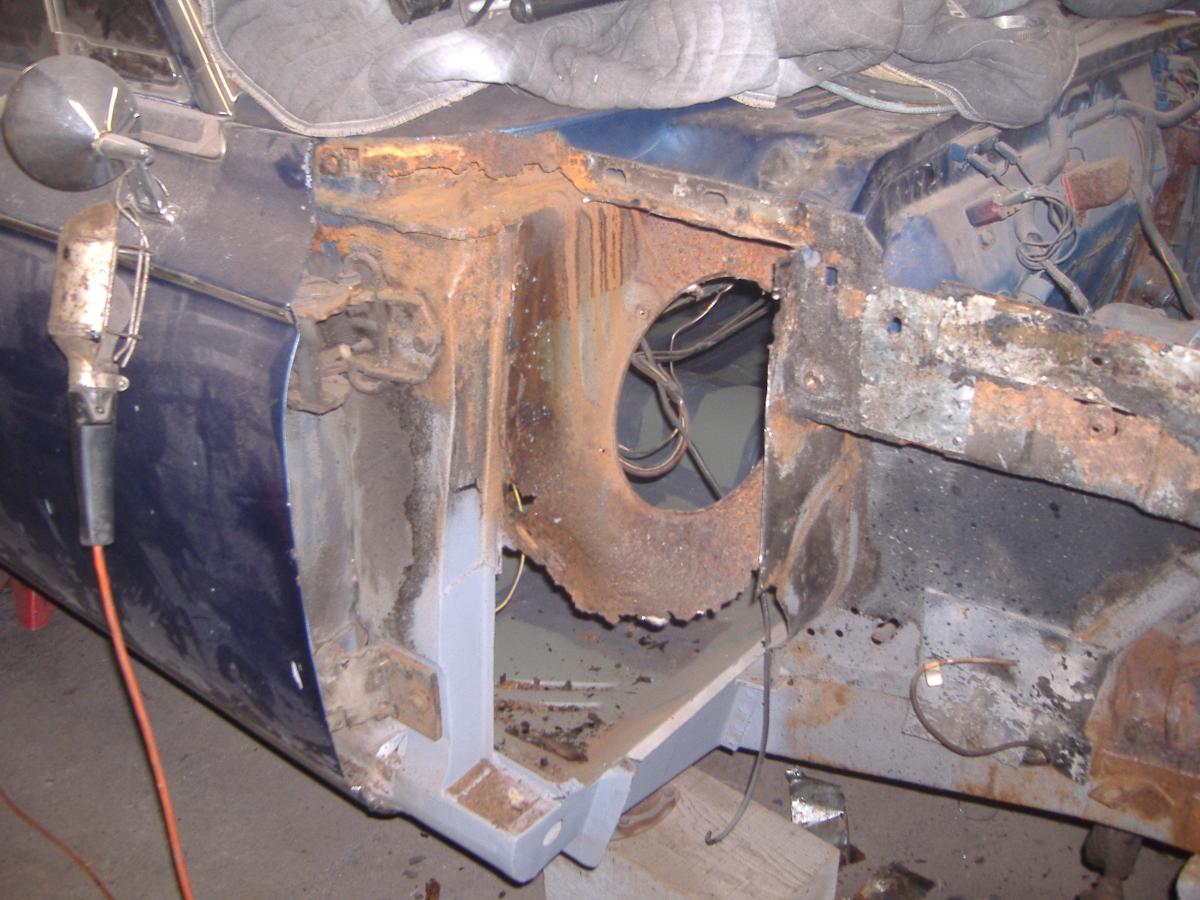

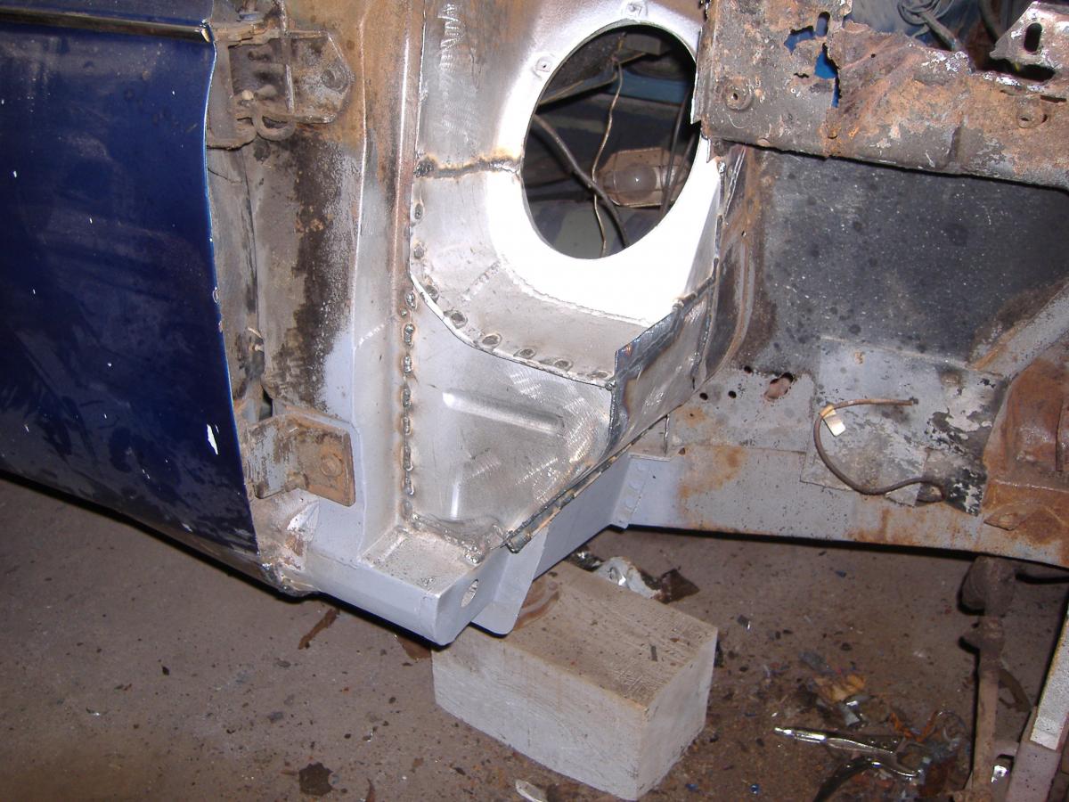

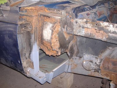

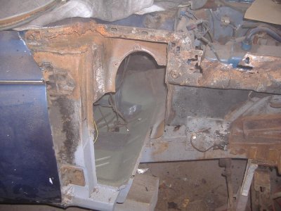

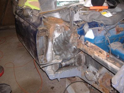

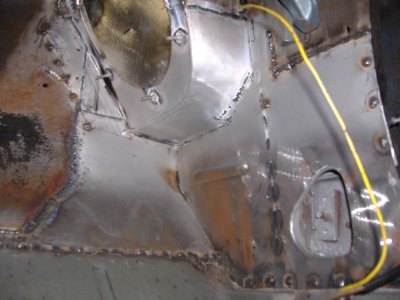

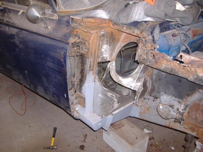

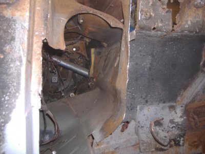

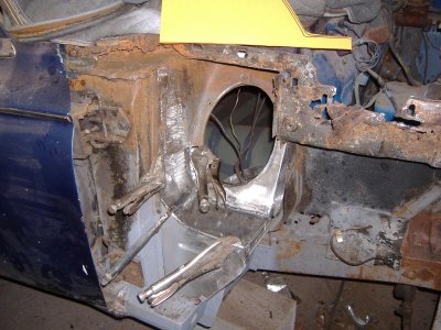

Alright....lets see if we can close up that gaping hole on the pass side cowl area.
The hole is big and gets a bit bigger as the bad is cut away!

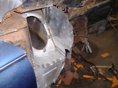

The inner trough has to be remade but the upper inner sections seem to be good.
I'll be removing the cowl top later to make sure.

What percentage of the sheet metal do you figure you will replace on this unibody? About how many hours you got into this? I'm sure by now you donated some blood and skin to it right?

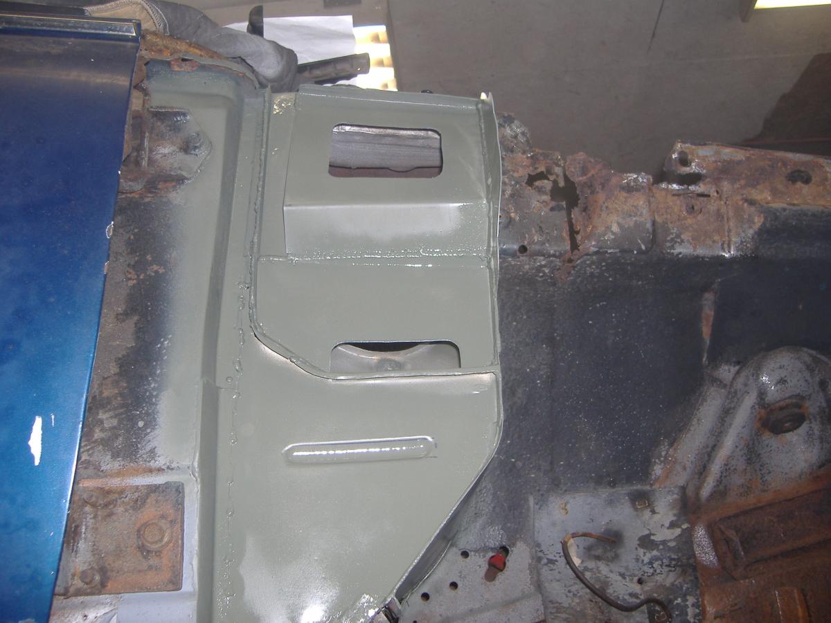

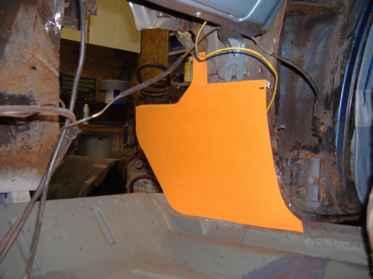

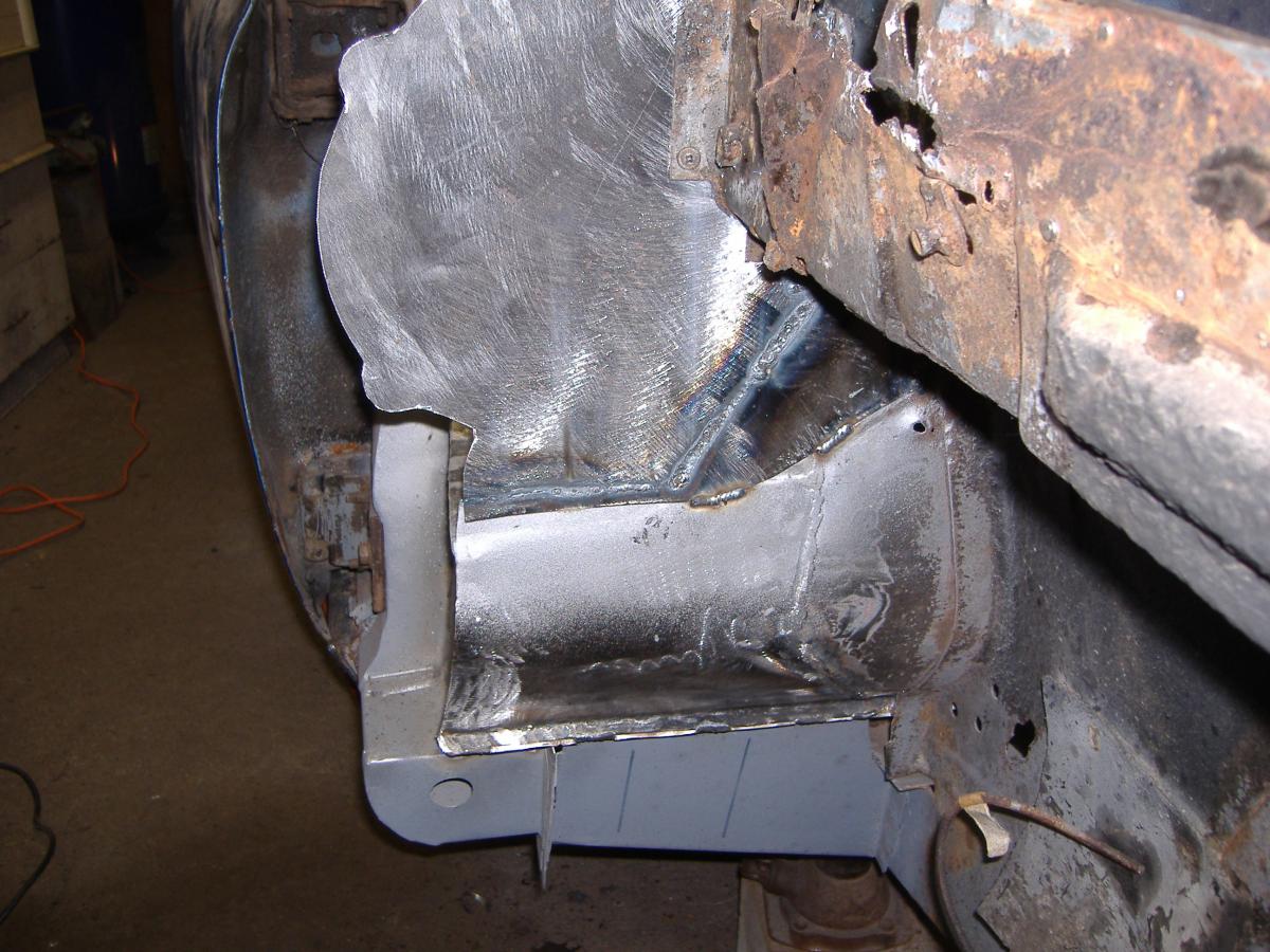

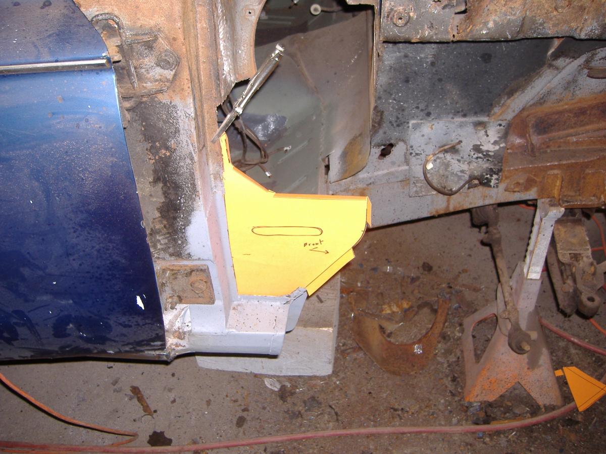

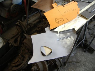

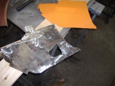

Made up a front section to look like what should be there and pieced together the lower/outer with a drain hole.

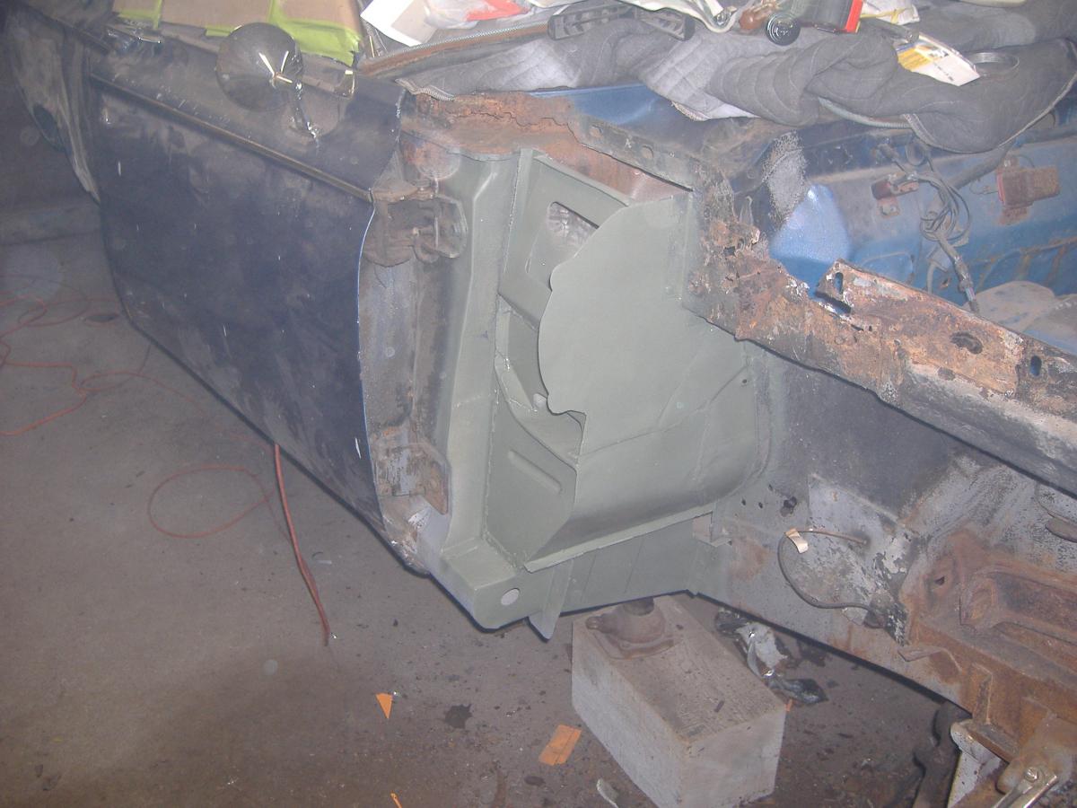

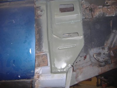

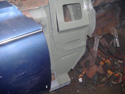

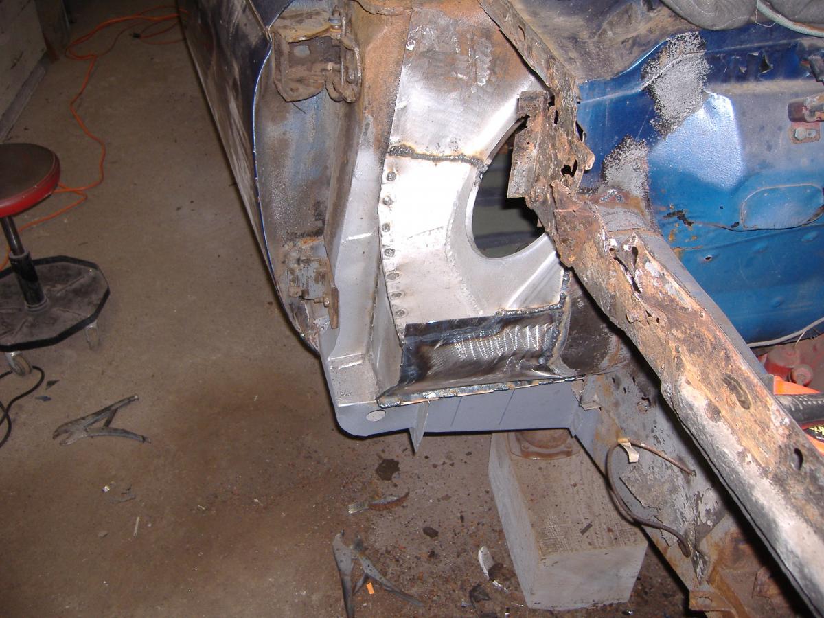

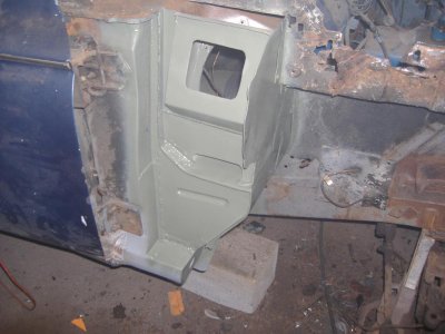

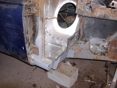

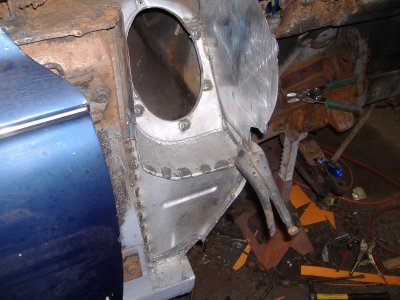

Decided to change the shape a bit to allow for an access hole for cleanouts and repaints. It will get a cover before the fender goes on.
Don't want to ever cut this apart again!

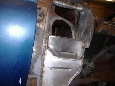

Not quite finished but I shot some primer on it anyway just because I needed to see it cleaned up!
I'm leaving the top off to allow for sealing and painting of the important lower sections. Once the top of the cowl is off and the inner cowl inspected and repaired as needed it will all go together for a final time.
The war is being won, one battle at a time...:)
