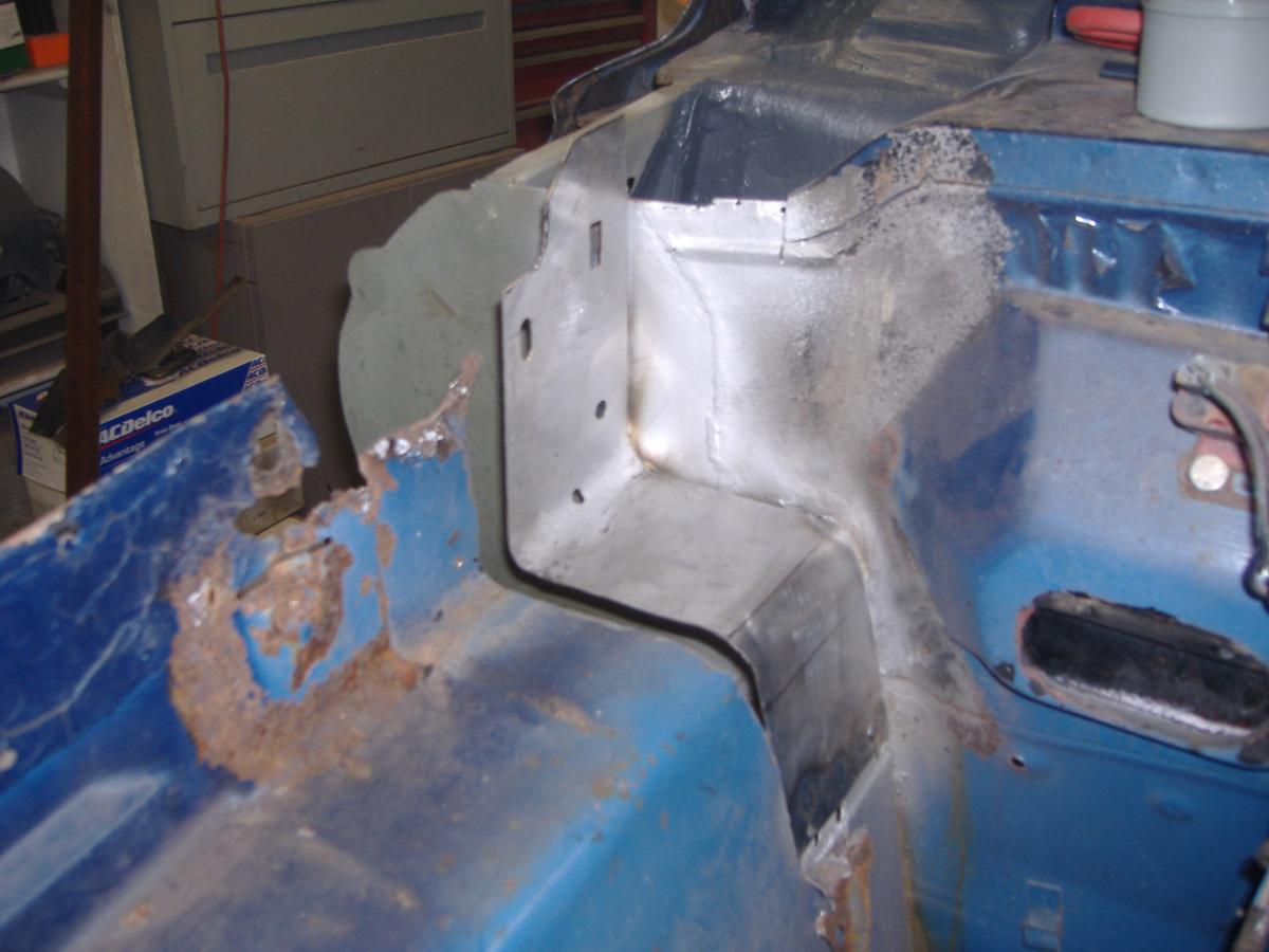

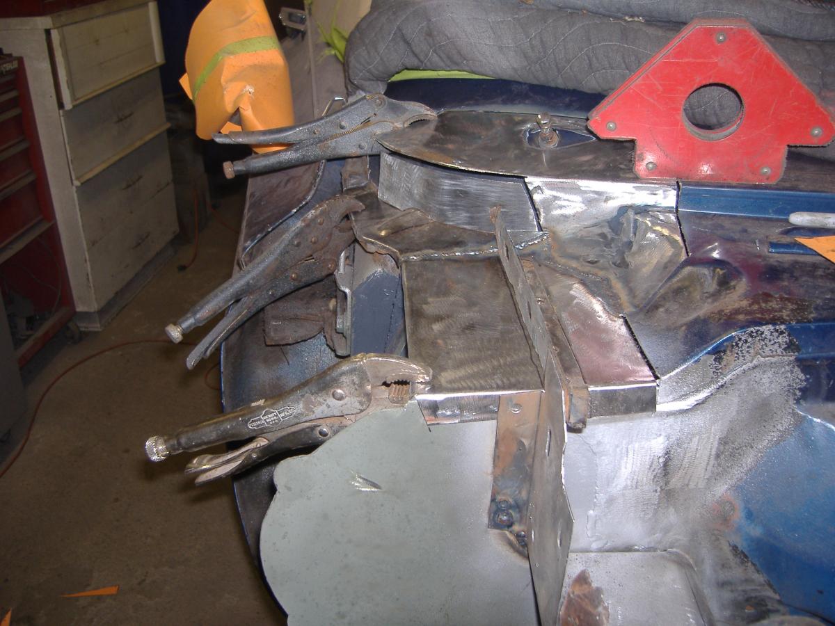

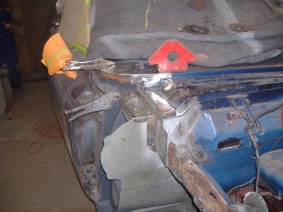

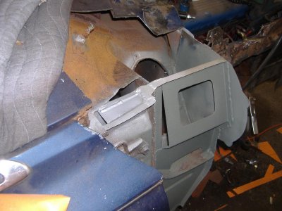

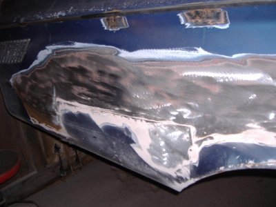

Cut the top off the cowl on the pass side. Some hidden rust but not as bad as it could have been.
A bit of welding and one large/one small patch took care of it.
Had to replace a couple of innerds on the top of the door post and then get everything tided up for sealer in the lower sections.

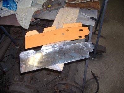

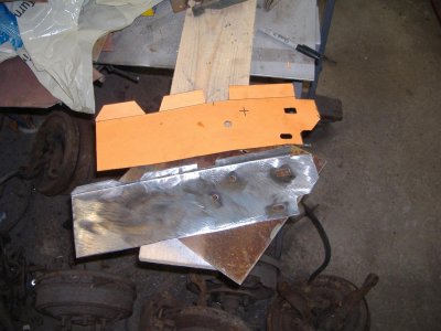

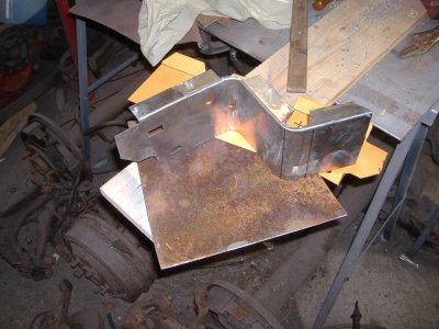

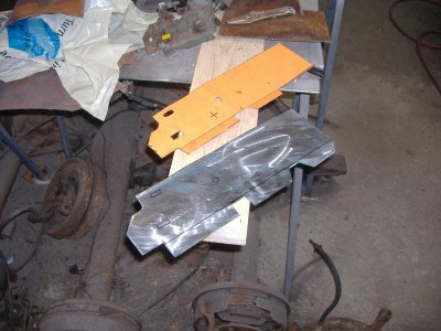

The apron extension was bad on top so I made a new one. The holes were tricky!

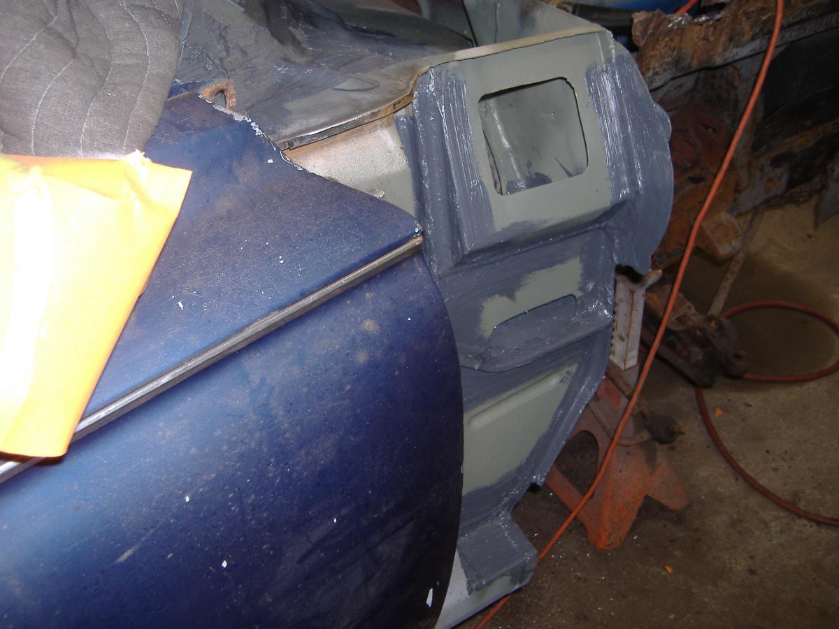

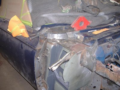

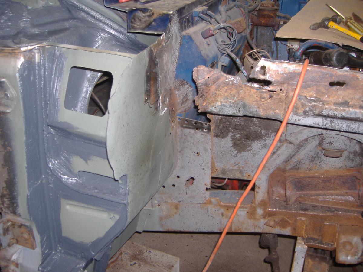

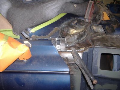

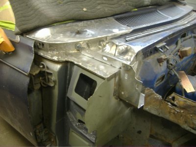

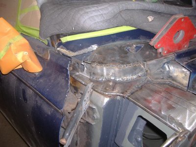

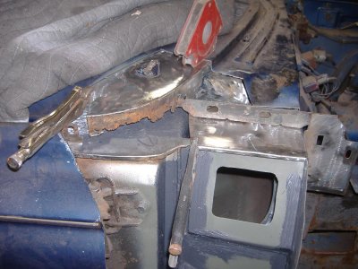

Started to repair the cowl top panel. Real pain in the butt as it ended up being a load of small sections that needed to be welded inside and out to make sure the joints didn't let any moisture thru.
It worked out...just a bit more work than i figured.
The access hole in the side will make it much easier to rust treat the inner parts of the cowl in that area.
Next up is to replace that right apron with the donor one I have from the donor front I picked up to get the Torsion crossmember.
That front was a really good score!

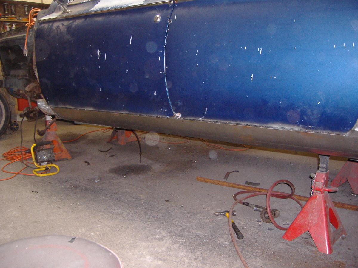

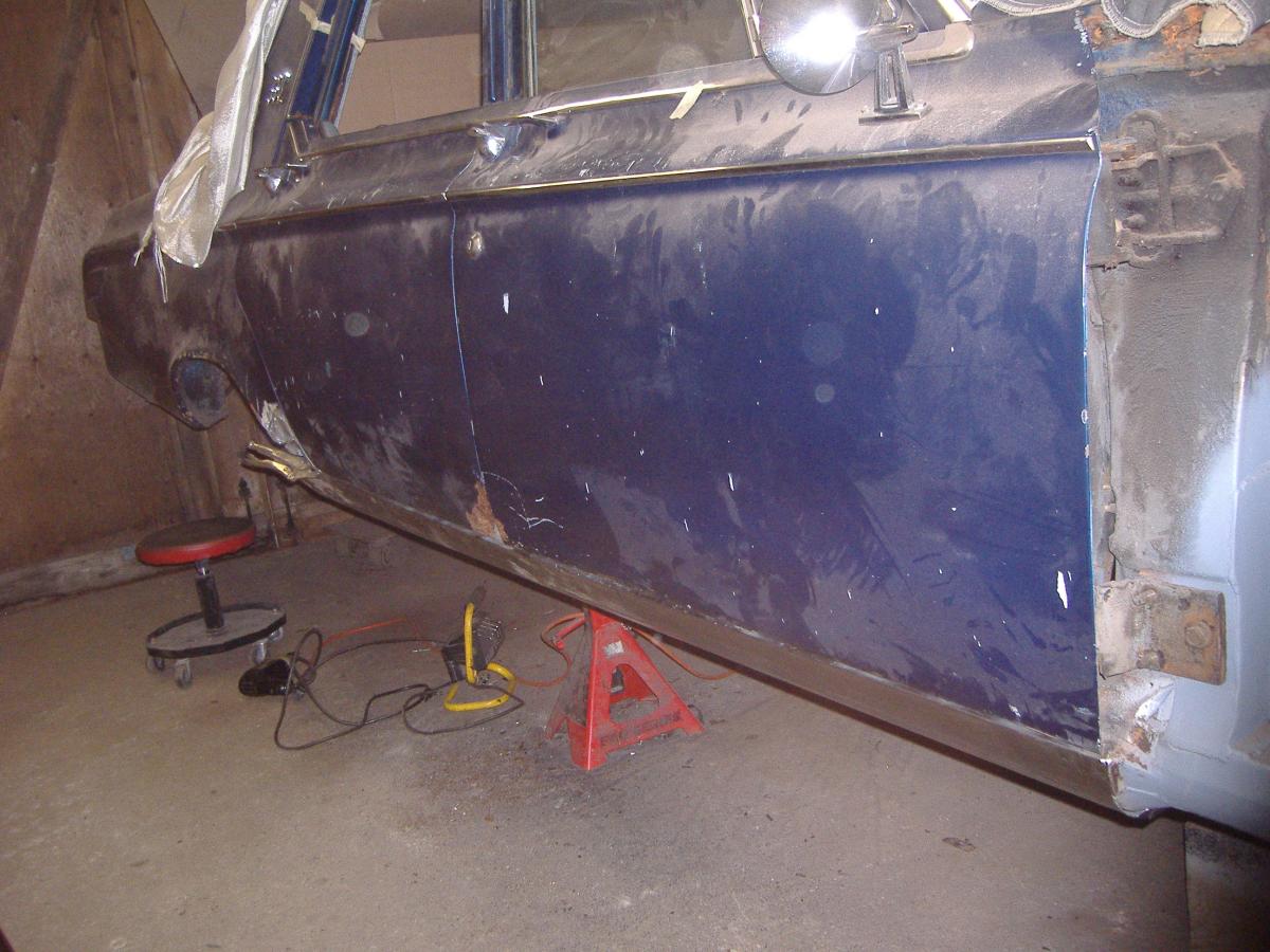

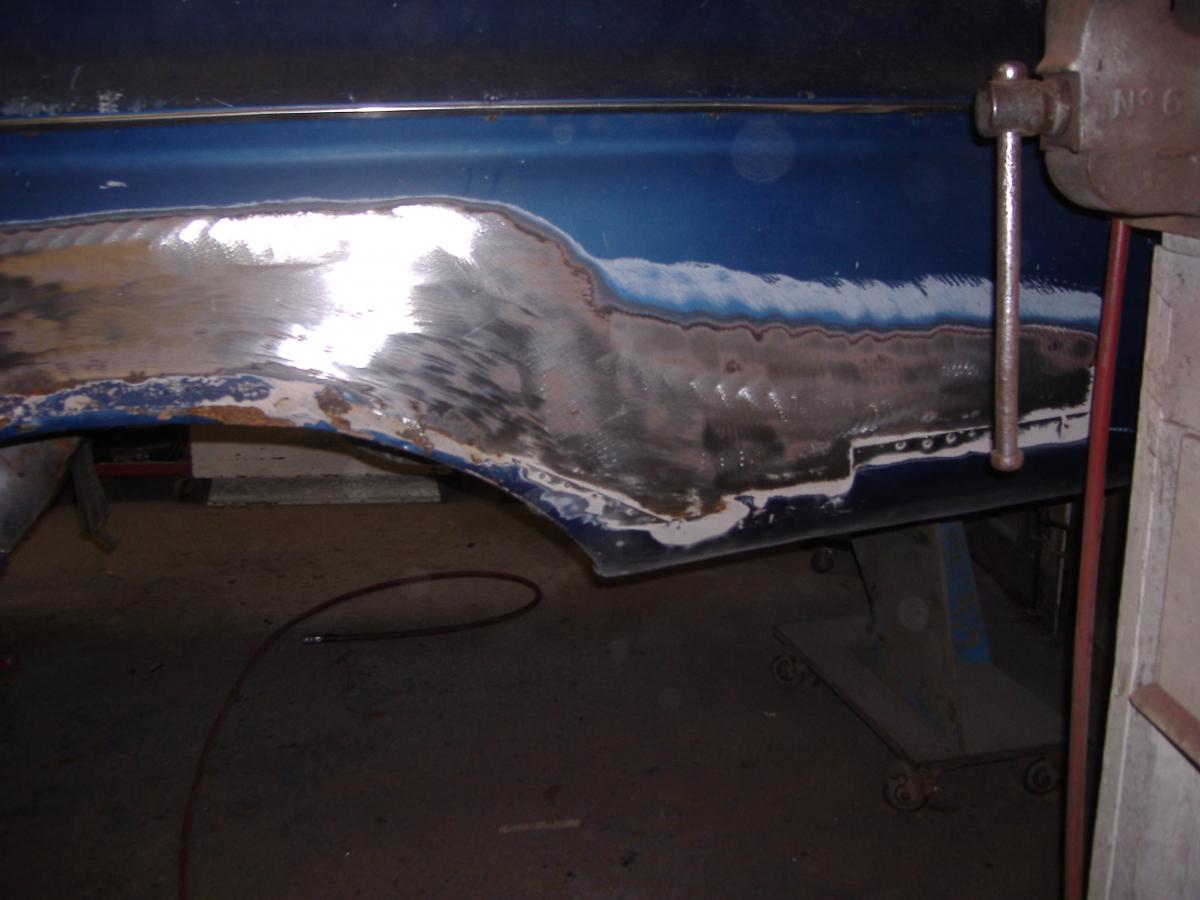

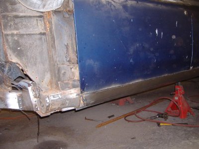

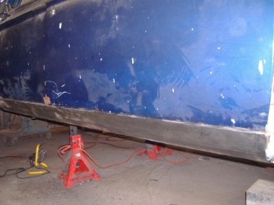

Forgot to mention that I have the rocker panels on now as well.
VERY important note for anyone who intends to get rockers made at a local sheet metal shop...get at least 18g metal as thats what the originals were...or even go to 16g as the things are dead straight anyway.
I made a mistake and told the local guy to use 20g and I also didn't tell him it was for a car under restoration and needed to be good.
He gets lots of rusty junk needing rockers where its just for a patch up so being exact isn't an issue.
It was MY mistake not to make it clear to him that these needed special attention!
The combined result was that the bends were off a bit, he didn't round the sides - just broke them in a full length line AND they were a bit floppy due to being a bit thin.
I used them after much work to correct the mistakes and the thinner metal isn't a real problem for me due to the subframe connectors...but it COULD be for you!
Basicly, i took them to a good friend who English wheeled the line out and gave them the proper crown...totally saving them from the dumpster...then I cut off the flange and made new ones to weld on at the correct position.
The floppy nature of the required low crown and the 20g metal made installation an alignment nightmare.
I SHOULD have just went back as soon as I got them from the shop and ordered new and better ones made from 18 or even 16g.
All this in order that you guys DON'T make the same mistake I made...although they DID work out OK in the end.
I don't have a load on installation pictures as I was too pissed off to worry about pics!
Not everything goes as planned and sometimes you get a bit stressed out.
Rockers are usually kinda EASY!

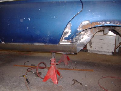

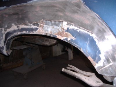

Oh my...LOOK at those wheel arches and all the pop rivets in the quarters...sigh.
I was told that the arches you can buy are total crap.
That true???
