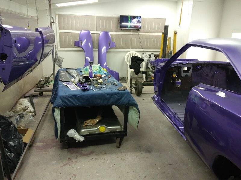

I fit and do all bodywork to the edges before disassembly ...... this eliminates any surprises after things are painted
If you do then why disassemble? Do you shoot the panels separately?

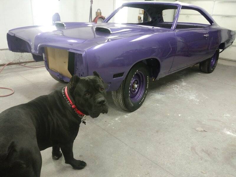

most everything i do goes on the rotisserie as a bare shell....... so any major metal work and bodywork is done first....... then, since everything must be cut in anyway; I just go ahead and paint the parts in full...... then assemble the car, see what I have, and address any issues at that point if they exist
the above is a V code 4 speed car...... pulled out of a junkyard stack, with a crushed roof and severely bent in half behind the torsion bar cross member.....more miracles than Jesus :D
damn man, awesome work. I pretty much worship guys that have the skill and patience to pull that off. I only dream of being able to do work like that.
damn man, awesome work. I pretty much worship guys that have skill and patience to do that. I only dream of being able to do work like that.
Thank You, and believe me......in some ways, it's a curse
