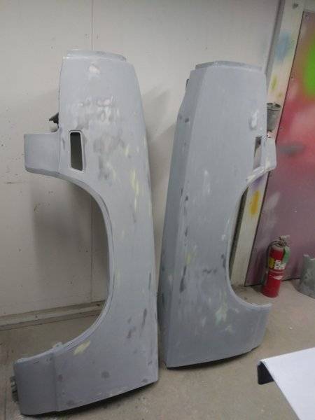

last job I did, the fenders and hood were really rough, bordering on junk but not rusty....... someone had sandblasted them into oblivion. Lots of work, but came out great
after sealing bare metal I rough in and glaze my filler work, I do not care about breaking through the initial epoxy coat because it gets recoated with epoxy anyway. Then I block it, glazing putty where needed, and reseal it......as many times as it takes, finer sanding each time....... these fenders and hood probably went 3, maybe 4 rounds in some places

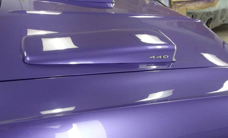

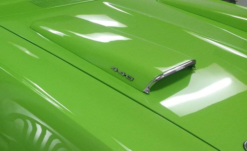

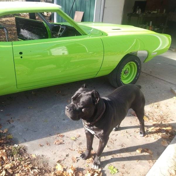

View attachment 1395675View attachment 1395676

I gotta ask. What paint color and mfg is that? Also what clear is that? It looks great! Is that fj5 or fj6?
Thanks. So SPI’s epoxy is different in that its highly sandable right?
yes, sands easy without clogging paper. I hate dust, but I sand it dry; it's fast, and I can see as I go. It also keeps water off any bare metal and filler. the above panels were sealed over metal, bodyworked, primed, sanded with 120/180 on durablock touched up with glaze and reprimed. Then sanded with 220 on durablock and reprimed.... at this point they are pretty much laser straight and I do the next sanding with 400 on a DA with an interface pad; maybe followed with 600 wet if metallic color.
the above is SPI high siolids clear over Wanda (akzo nobel) basecoat. SPI clear works with any quality base...... and yes, whatever the code is for 70 limelight
the top banana and plum crazy below are matrix basecoat. I slide a little 800 wet over base to de-nib between coats when needed. Base can be a pain in the *** clogging paper, I try to keep sanding it to a minimum
