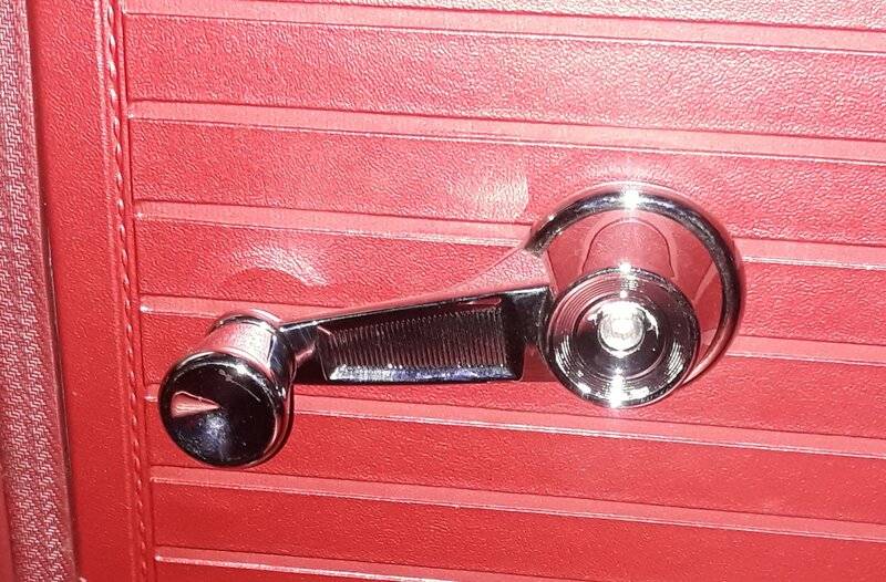

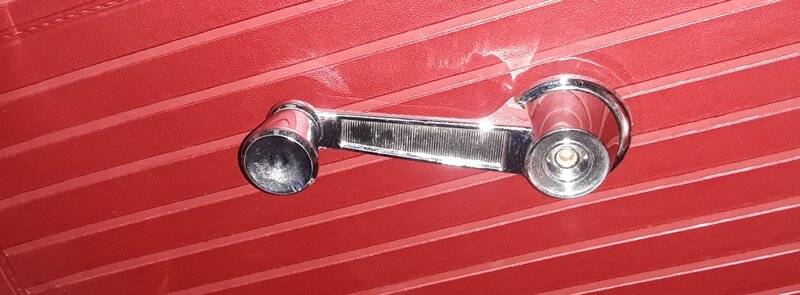

BUT, fronts are 3-1/2" center to center length
Rears are 2-5/8" center to center length
66 rear cranks are shorter than the fronts...but...
there's no reason they need to be.
The machinations of the 66/67 rear windows require torque and those puny, short cranks struggle.
You absolutely can use the longer frons cranks for the rear, and operating the rear window becomes MUCH easier.
