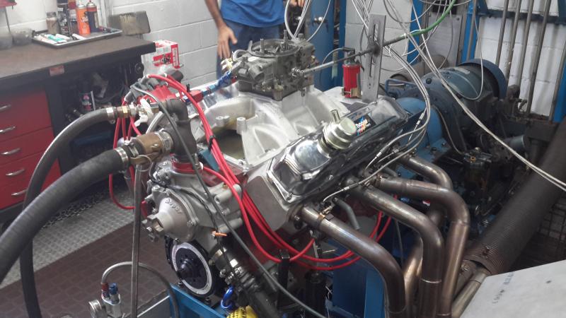

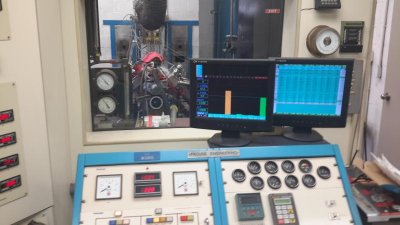

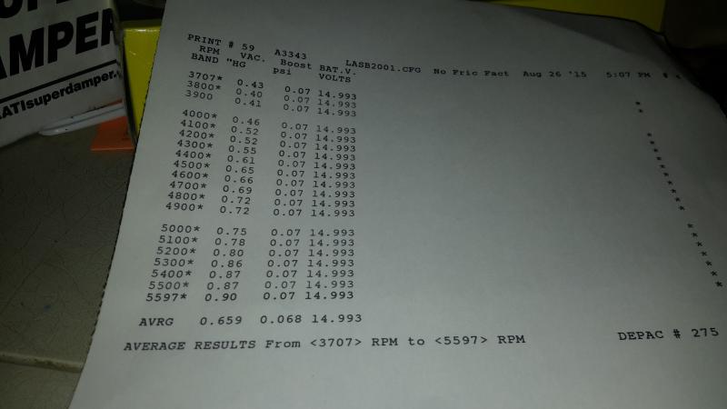

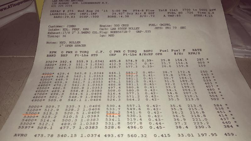

Hay just got my 493 pump gas ( 440 block ) motor on the dyno today, Eagle Crank, Rods, Icon 9.7-1 pistons, out of the box Eddy RPM Heads, mild Crane Hydalic Roller cam HR -230 -352-25-12 , Crane roller Rockers, performer RPM Intake, 850 Holley, Milodon oiling system, ARP everything.This motors going into my 67GTX. I'm not chasing 10th anymore thanks to the Doush nozzle who decided to sell my local dragstrip to land developers, nearest track is 120 miles away, so I'm taking it to the streets so to speak.might get to the track for a mopar event to blast it down the track, hopefully life's little obsticals won't get in the way. This combo made lots of tourqe here's the first pull and the specs thought I would share. Studio_20150827_105702.jpgStudio_20150827_105949.jpgStudio_20150827_105926.jpgStudio_20150827_105859.jpg20150826_160128.jpg20150826_162908.jpg20150826_172536.jpg20150826_160606.jpg[video]https://youtu.be/WjjneSiNKhY[/video]

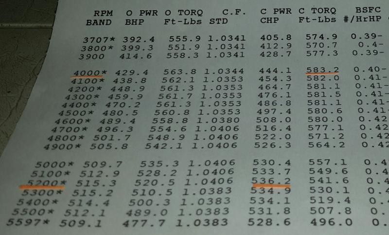

Hey bro - can't really read the sheets. What kind of hp and torque did the 493 beast pull on the dyno. Sounds cool as hell!
536Hp at 5200 rpm and 583 TQ at 4000 rpm, the torque band is broad, pulled high 500's pull was from 3700 to 5600 RPM lots of lower grunt stump puller ; -)Stump puller .jpg
