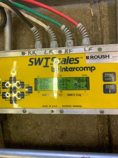

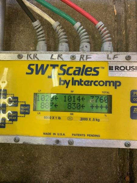

Scaled my 64 Plymouth belvedere HT. All steel 8pt roll bar no back seat ,cheap plastic race seats & no heater box. It has a 505 crossram,727 & 8-3/4 leaf spring rear. Without driver 3,462 RF 1019, LF 848 RR 746 and LR 849. Front 53.93% and Rear 46.07%. I have a Dana 60 done and will go in it before I hit the track. Not sure if these splits are good or not thoughts?

yes the left to right weighs are what I'm concerned with.

Yeah, I'd be wondering why that is myself. Are you sure the scales were accurate? Can you re-do it and see if the results are the same? Also, as I've always know it to be, the "Right Front" is the passenger side. Could you have left and right mixed transposed?
Can't think of much that would add that much weight to one side vs. the other. If anything, it should be heavier on the left front (master cylinder, steering column and box, brake pedals, etc.) and right rear (extra leaf in spring) but yours is opposite. The center section is offset slightly to the right but I'm not sure if/how much that would affect L/R the splits.
Is your battery in the trunk? If so, what side? Should be over the right rear. Are there any extra bars around the driver? When you say steel, we're presuming it's "mild DOM" over chromoly which is obviously lighter.

Try cranking up the drivers torsion bar until the front weights are close, then take a look at the RR height. This will give you indication of the actual condition of the pass rear superstock leaf spring.

Your RF LR cross weight is good for a jalopy circle tracker with no sure-grip.

The RR/LF is light. Being you have SS springs there really is a a way to add RR preload. I would suggest turning up the LF torsion bar. This will shift the weight to the LF/RR. It will also remove weight from the RF/LR. If it has enough power the way it is set-up now will cause it to drive to the right. There can be one problem with moving weight by this method. If the car is prone to long distance wheel stands, 25 feet or longer. The added weight transfered to the RR is gone when the front wheels are in the air. Then it'll be back to driving to the right. The front to rear weight bias isn't bad. Mine is 54.9% on the nose. Doesn't bother it a bit. I'd be afraid to take much off. For what it's worth it has the factory original 6 cylinder bars. Over 850 passes worth of wheelies. Yours will be fine. Lots of stuff you can do to lighten them . Mine is all steel, Dana, Mega block, full interior minus the rear seat. With my 200lbs I can get it close to 3280lbs.

Thanks for the reply. I don't have a problem with wheelies (wish I did). How tight can I turn adjusters? I have about 3/4 inch of threads left
As tight as it takes. You can also loosen the right side. Have drivers weight in the car. Move them until the right rear is about 10-20 lbs heavy. Jounce the car up and down. If you have to jack it up roll it back and forth while bouncing. Then weigh it again. Do not jack it up to get on the scales. Rollit onto them. May take some wood blocks to do that.
