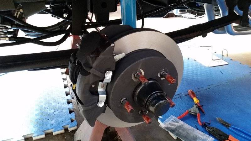

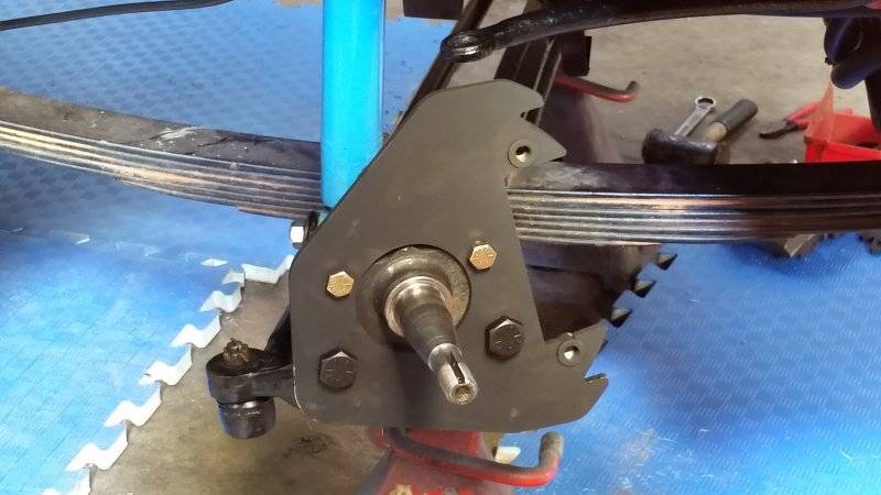

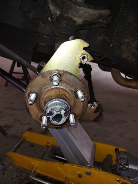

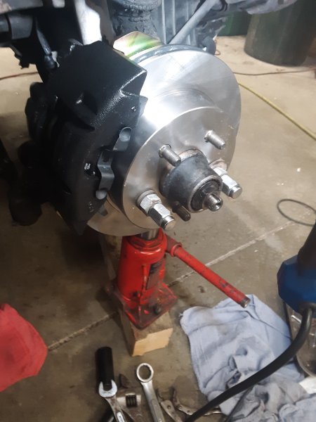

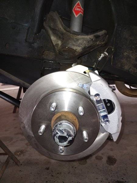

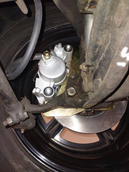

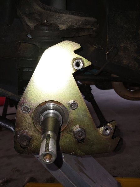

I did a Scarebird conversion on my 66 Charger a few years ago. Mine used the stock 10 inch drum brake spindles and 10 inch Lincoln rear rotors, but it did use the same Celebrity calipers. Works great in my opinion.

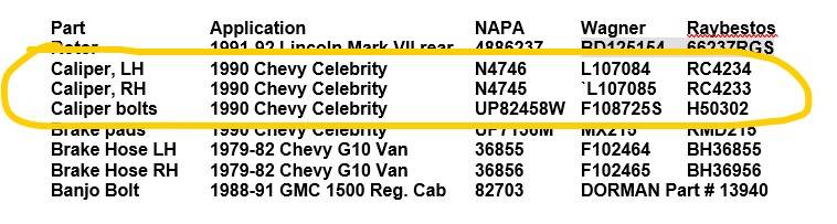

I used the Scarebird kit on my A100, and the parts list included the 1990 Celebrity brake calipers as well as Lincoln rotors.
Some of those numbers don't jive with the alleged suppliers....so a little creative adaptability is required. Also worth noting is that the recommended brake hoses are not worth the money wasted on purchase....I had custom hoses made locally from -3AN hose and fittings - fit and look much better. The Chevy offerings are horrible clunky and over-sized to the point of looking downright ugly. To me, it was sheer laziness for Scarebird to suggest those hoses....as they weren't even close to fitting correctly. The caliper brackets are nice though.

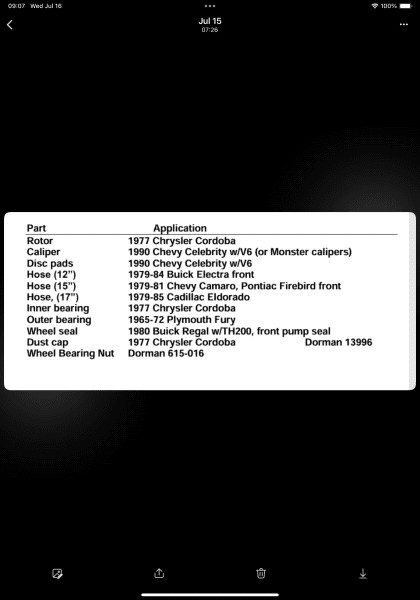

Thanks! They are telling me to use the 11.75” 1977 Chrysler Cordoba front rotors with the Celebrity calipers. They say it will clear my 14” road wheels.
