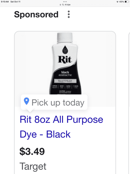

"ordered" !!!! You can't find this **** "off the shelf" ???
Maybe he lives in the sticks like me. I have to order a lot of things that aren't available "off the shelf" locally.
I’m 30 miles from any place that would have it. Now it will just be sitting by the front door before I need it next weekend.
