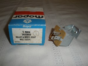

originally Mopars assemblied in Venezuela never got this interlock system BUT since I'm "cloning" my Venezuelan Charger to a NorthAmerican 74 Charger, I got all the system from there and is in working order. In fact got a NOS blue interlock box and a Canadian orange box too ( which is not really interlocked ), actually is with the Canadian unit ( non interlocked ) to make work all the buzzing and warning signals system, but I tested the blue box and everything works correctly with it
Remove connections below the seats. Both driver and passinger seat. This will allow starting without connecting belts. 1974 only year with this requirement
I had it installed on a 1973 Roadrunner.
not interlock system, just warning lights and buzzer system relay controled, not control box like 74s.
this is what 73 uses ( and 72 ).
this is what 74s uses ( for auto cars... manual are white, non interlocked boxes are orange and green on laters )
Both located on same area, close to glovebox, underdash
Beside that, 72/73s got the seatbelt sensor on retractor. 74s got it on female buckle

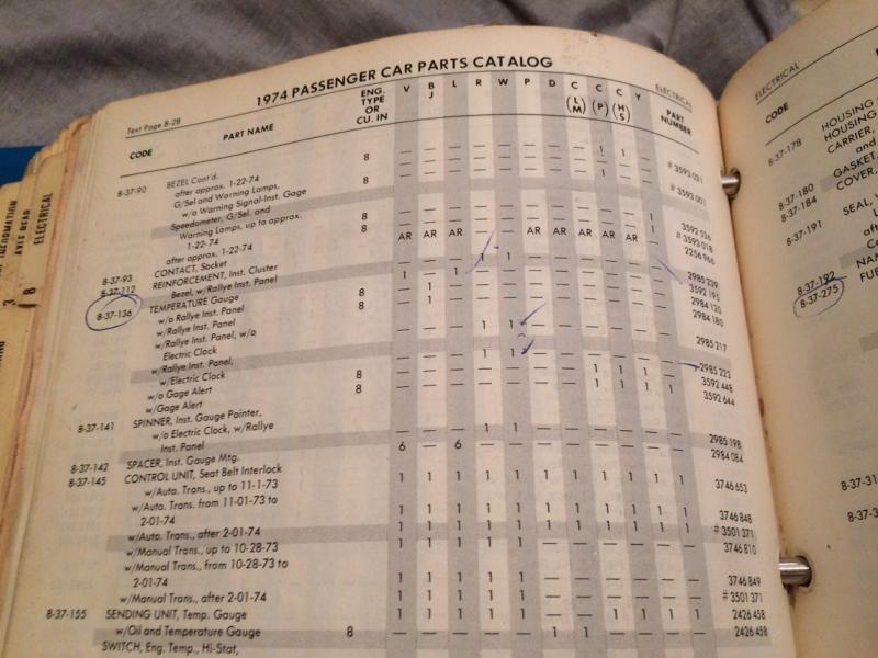

Talking about date production, dunno if this helps ( taken from a april 74 catalog ):
Check the item 8-37-145
Maybe some VERY lates 73 could get it ? dunno.
