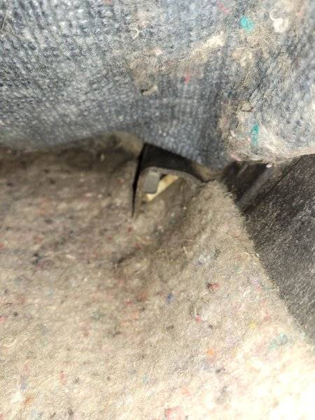

Hi all,
I installed sound deading mat and new carpet in my '66. I found the seat belt mounting points. The problem is the driver's inside (tunnel) mount. It's the L shaped bracket, but the bolt does not catch on any threads. I tried a longer bold, no different. Is there a capture nut or maybe loose nut on the inside of the L bracket? I think I have the hole in the right spot because it passes through the rear center console.

The seat bolt should not be going through the console l bracket. If you get under the car you will see where the seatbelt nuts are.

You made me go routing around in my racecar, and sure enough, I hadn't hacked it out. It has a large nut that's fused to the bracket. Yours must be broken off
And ya that appears to be a smoke laying there
You made me go routing around in my racecar, and sure enough, I hadn't hacked it out. It has a large nut that's fused to the bracket. Yours must be broken offView attachment 1789567

Yours won't have it because the 67 console is short. My 67 with a 66 console could use it. My seat belt just goes through the hole to the tunnel.
It's just 1 of those 200? Differences between a 66 and 7
I think a 66 may have both belt mounts.
Yep , I put the race belts in the tunnel hole. The other one is straight out to my finger
