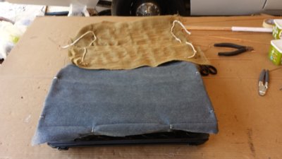

The rear bottoms are one piece of 1 1/4 inch think foam.
If you get the 1 inch and 1/2 inch sizes you can glue them together.
I just bought the whole sheets since I didn't know exactly what I needed.
Put the complete piece where any seam isn't in a "fold" on top.
I may be getting ahead of the process on that but here's a picture.
Measure your old foam.
I can't remember the dimensions. But I used the same dimensions as the factory.
Looks like you will need a little over 2 feet both ways.
So, you can get one dimension in a sheet but will have to piece together the other dimension to get what the factory installed..

On the rear bottoms I put a layer of felt, then burlap and another layer of felt around the appropriate edges.
So that's double felt on the front edge. Mine is better than what was on there.
And that wool/rayon felt material is anchored on the edges as well.
Tough stuff.
Notice that I put more where the person's rear is going to actually be in the seat.
