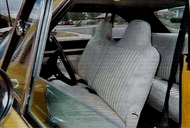

My son's 72 Dart Swinger is stuffed full of Legendary Auto Interior parts after I restored it's interior in 2004 and I'm getting ready to do the same with my 66 Coronet 500 with LOTS of their parts. :grin:
Richard
1972 Dart Swinger- restored with BEAUTIFUL Legendary Auto Interior products! .jpg
