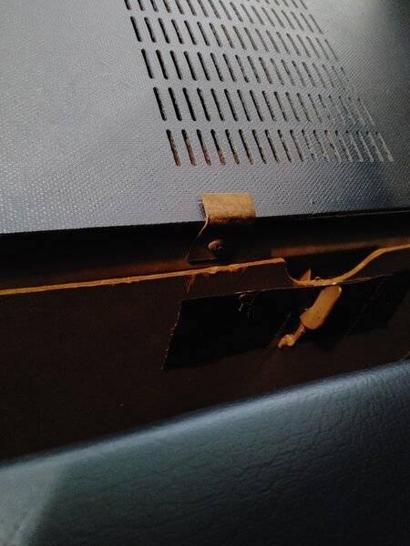

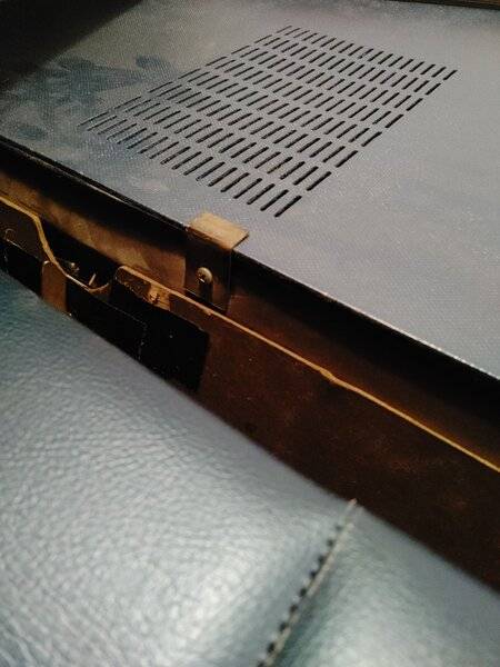

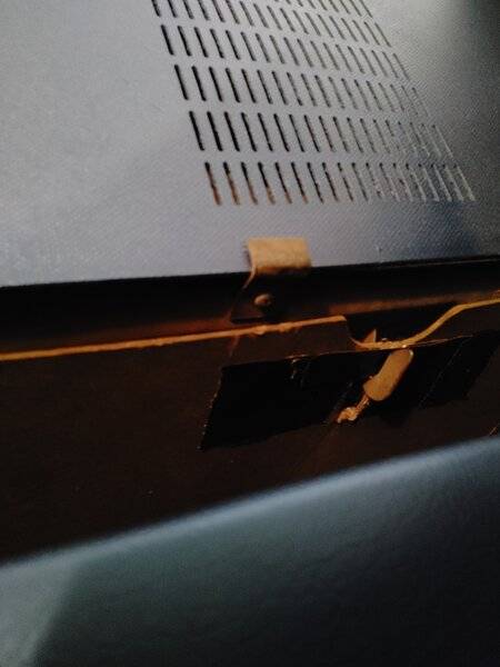

Do the two clips that screw at the back hold down the rear shelf? Are they painted . When I hang the rear seat you can see the clips. They seem to hold the shelf . Didn't notice them before

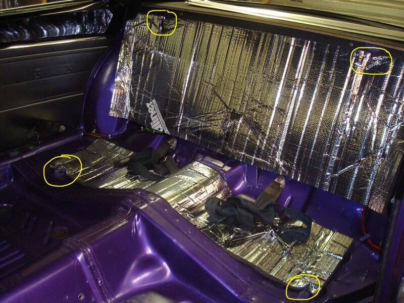

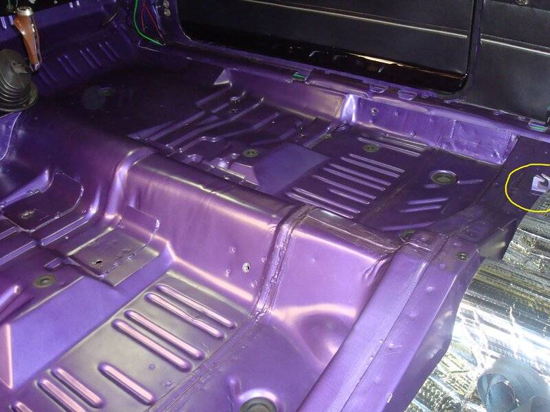

The top of the back seat goes in first...as in the vertical seat section.
The top hooks onto the frame brace hooks, and the two bottom loops have a tag that crimps over to hold them steady.
The bottom seat cushion gets pushed in on a 30 degree angle (roughly) and locks into position by clicking the seat frame 'hoops' into the claw type brackets protruding from the floor.

Hope that helps you somewhat. :thumbsup:

View attachment 1273861 View attachment 1273862
Yes. Thank you for the pics and about the angle to fit it in. Will be easier to get in. Thanks again. I appreciate it.
