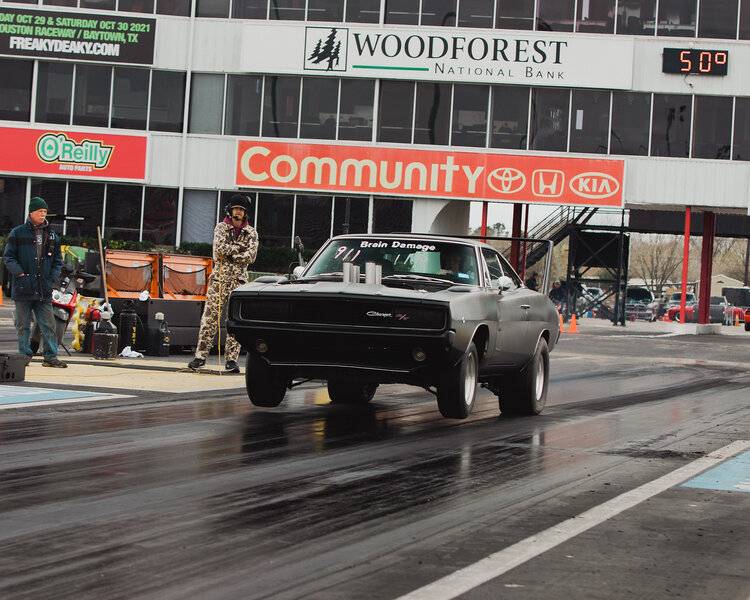

Asking the group to sell me on something that I already know I’m going to eventually buy…
Finishing my 68 Charger dream car. 383 powered street/strip car. Hoping to be in the Hi-13’s, Low-14’s range. 28x10 on a 15 wheel DOT slicks slapped onto my 8.75 with 3.91’s all held together by new Moser axels and this nifty Detroit TruTrac dif.
Buttttttt, stuck with the 54 year old leafys like a sticky Midwest day and they gotta go. Dad’s ran CalTracs on drag Mopars before and swears they’re the greatest money you’ll ever spend (he’s probably right) but goodness they’re pricy. But hey, can’t take it with you, right? I’m supposedly on a budget. Lol.
Before I yolo into the buy button, thought I’d get some last minute thoughts, comments, feedback. Are you an attorney? Change my mind or hammer me home like a sledgehammer. What should I be thinking about that I’m not? And send me them sexy pics of your B-Body with them on because why the heck not?
That sound you just heard? Likely me ordering. Or my bank calling me because I’m spending too much. Or both. Live life to the fullest ✌

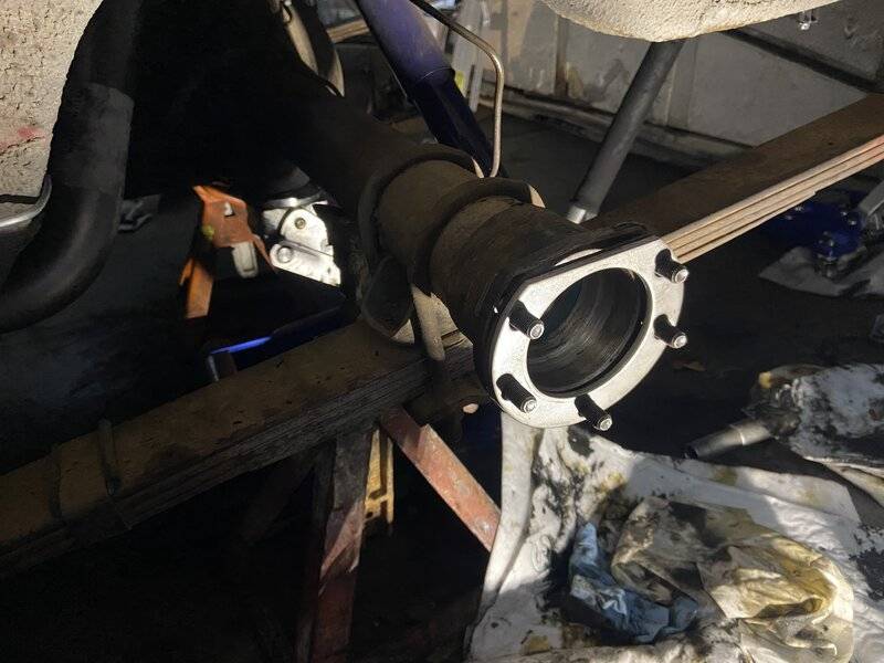

Same here. I was going to get a triangulated 4 link, from RMS or GERST, but "the forum" and my own research convinced me to go with leafs (Split mono leaf springs from Calvert) sliders in the rear vs shackles, and most importantly Assassin traction bars from Smith Racecraft. Mr Kim Smith was helpful on the phone, but I know Calvert is as well. The main reasons why I got Assassins was more adjustments, and the clearance was slightly less than low profile CalTracks, but more than full size CalTracks, and I definitely prefer the way they contact and interact with the leaf springs.
I agree with the others, get your leaf springs replaced if worn (I only knew mine were by having them wrap up so much on the 1st launch as to bend the mounting U shaped main bracket of the top of the line Mancini pinion snubber) and get a pinion snubber. I was running low 13s at 107 with 2+ second 60ft times, thus the traction aids and all kinds of other stuff I've added. Now maybe I can launch beyond idle.

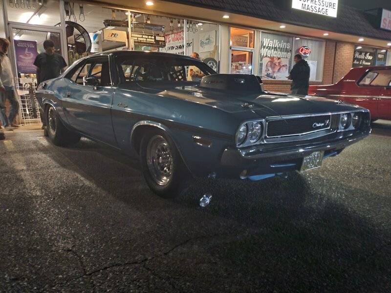

I have Catracs and split mono leafs on my Challenger and drive it on the street. No complaints. They work....

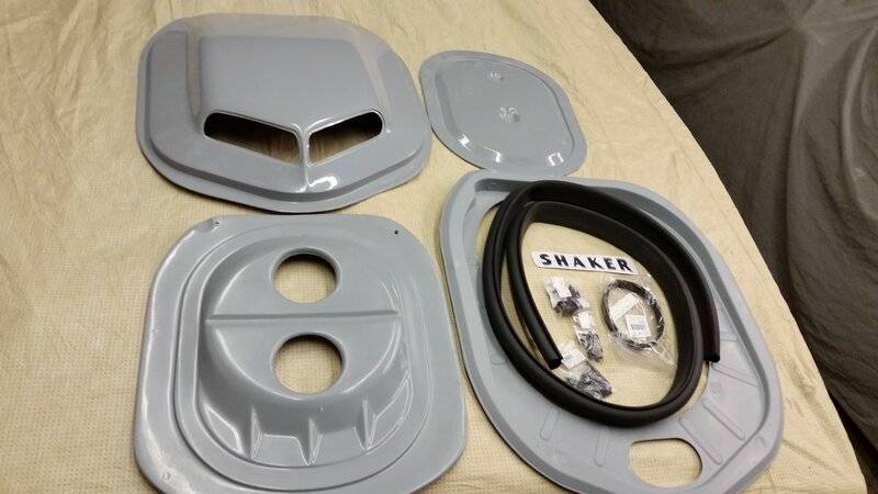

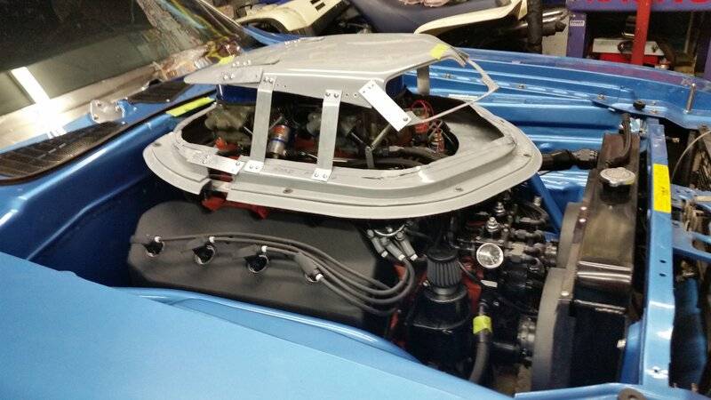

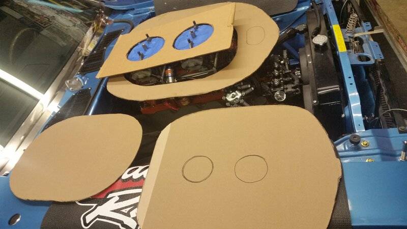

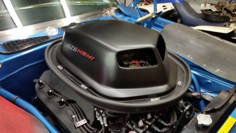

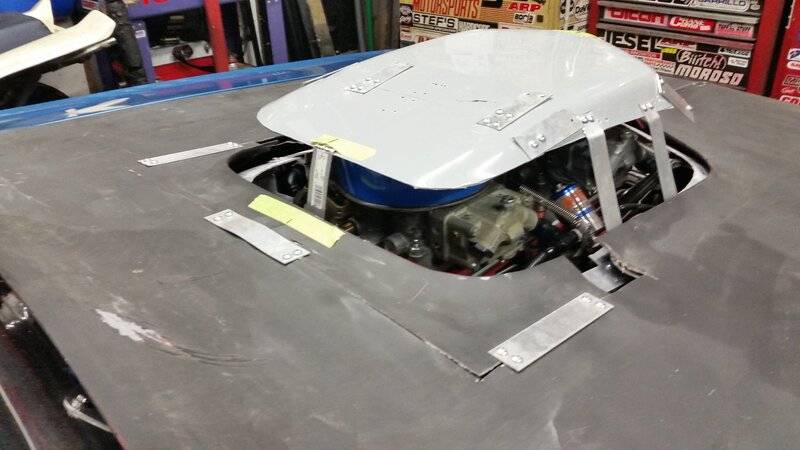

@6PKRTSE what is the reason for the obviously extra tall Shaker scoop? For my Bill Mitchell aluminum RB block based 572 I'm changing intakes on my 70 V-code Roadrunner N96 and one of the big reasons why I am using an Indy ModMan is to try to keep it low enough to work with the N96 setup, and I'm determined to use my Promax modded Holley 6bbl carbs.
Oh, and you deserve a :thumbsup: and a :lowdown: for having a 6 Pack RT/SE...
Uh, the tunnel rammed twin dominator nitroused hemi. Lol
I stretched the length of the hood opening, base and scoop 2", raised it 5-1/2" taller and opened up the nostrils 2-1/2" taller to clear all of this.

Thank you. It was alot of work. I think the end result was well worth it. I didn't want a big ole pro stock scoop or a Chevy cowl induction hood at all. I like to be different.
