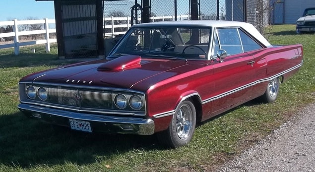

Nice ride btw
thanks do you have this blackcharger, ...........my box on car that will not fire
