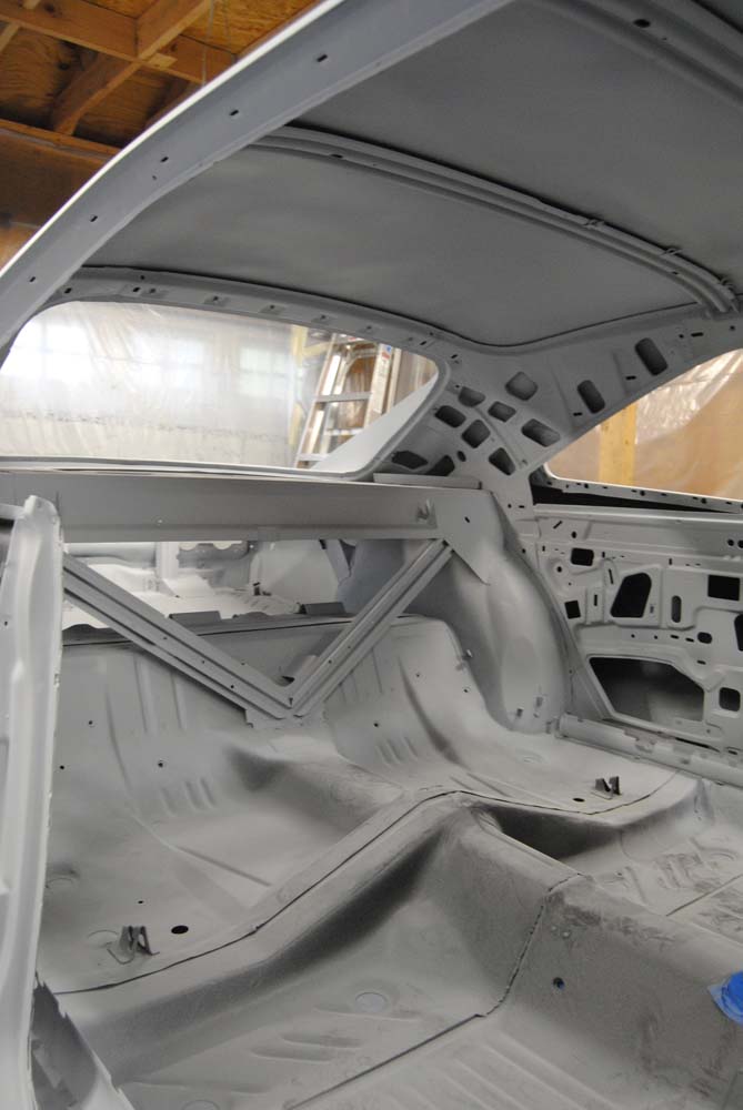

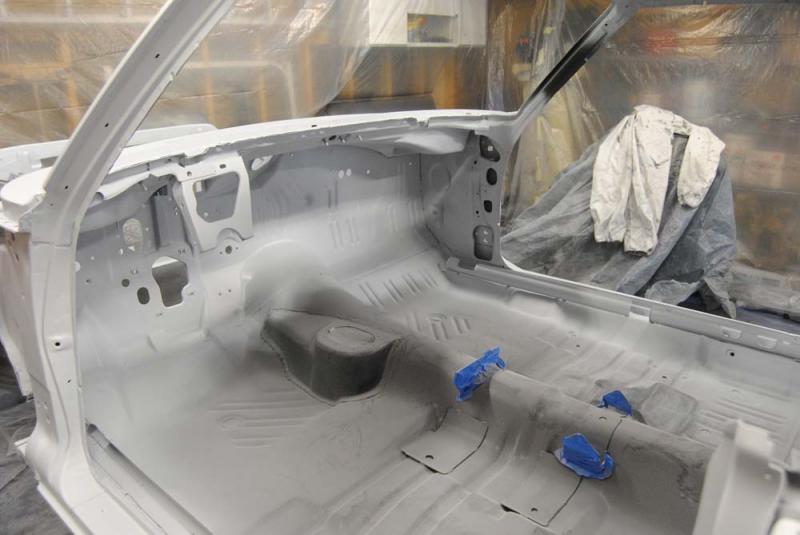

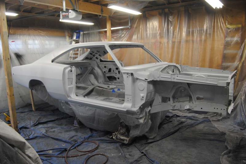

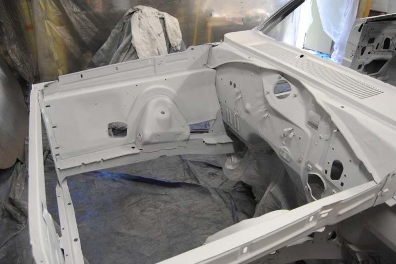

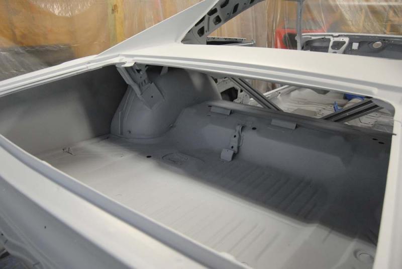

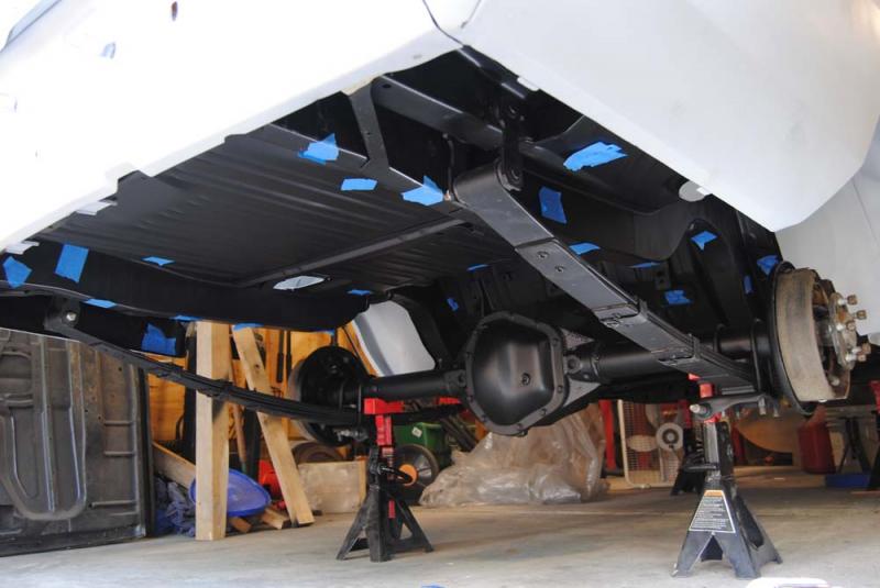

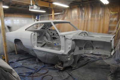

Thanks for the comments all! Over the last week I put another coat of DP90 on the whole car + a 3[SUP]rd[/SUP]coat on the underbody since that will be the final paint. It was nice and warm on Sunday so I was ableto get the K36 on the car to bond to the DP90 within the 10 day window. Thanks God I was able to do that since I had no ambition to scuff up the whole car… again :eusa_hand: . It was also a lot easier to paint gray on black as opposed to black on black :icon_sunny:. Now I need to get caught up around the house so I’ll take a little break from the R/T after a clean up. Probably start working on the suspension parts – blasting, painting, and refitting bushings and the like since it will be too cold to do any more on the body until spring. A few pics below.

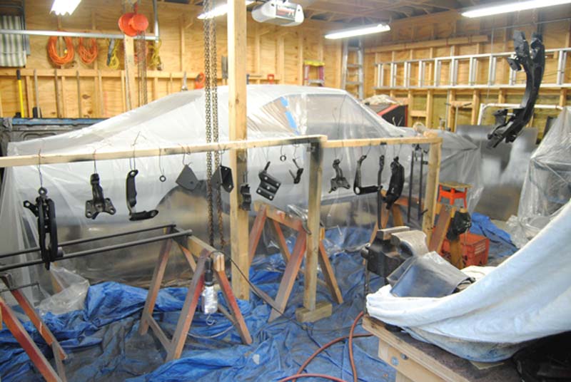

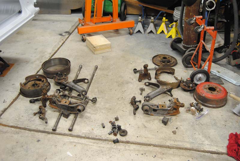

I’ve been able to poke my head above water at work enough to start working on my R/T again!!! Nothing major, but I’m at least moving my thread forward from page 5. I’ve taken the front and rear suspension apart for inspection, cleaning, and painting. My plan is to get the suspension all cleaned up, replace all the parts that need replacing, painted, and get it installed on the car. This was to be my winter work by the day job took all my time up. Don’t get my wrong busy is good, but it would have been nice to make some progress. I’ll be doing a little sanding and painting on the body soon – just enough to get the front suspension on so the real painter can paint without taking the suspension off the car. In my inspection of the front suspension I found both strut rods bent, and the wrong torsion bars on the car (dam past accident). Replacements found thanks to Cranky and another friend. Also started a tread on my leaf springs – join in on lending some advice if you please. http://www.forbbodiesonly.com/moparforum/showthread.php?52128-Leaf-Spring
Just a pic of torn down parts for now.
