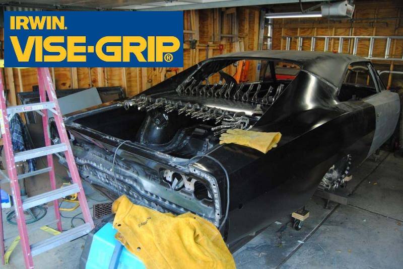

No doubt! Great work.... One full scale 3D AMD Charger puzzle....This thread is a great real time review of AMD's Charger line of sheetmetal. Also, a flagship for Vise-Grip :grin:
he`s testing their site the room in the corner :grin:
what`s gonna be the encore ?:grin:
LOL!! Thanks!! Oh kool! I now have 2 sponsors. AMD and Irwin!!! :eusa_dance:

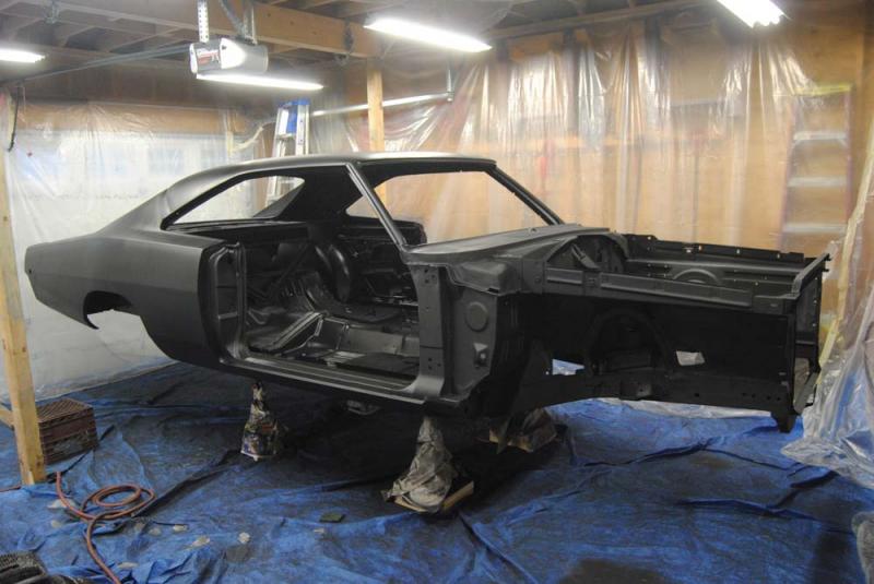

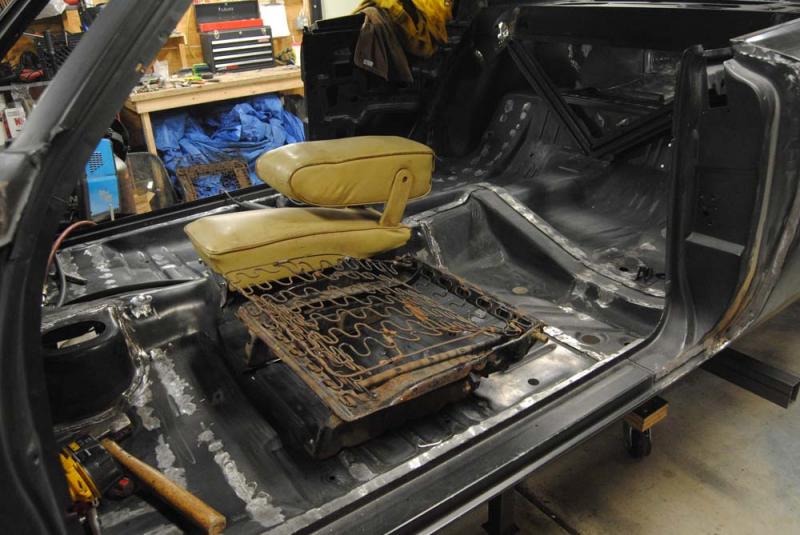

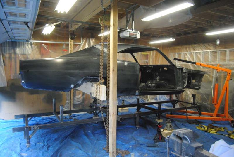

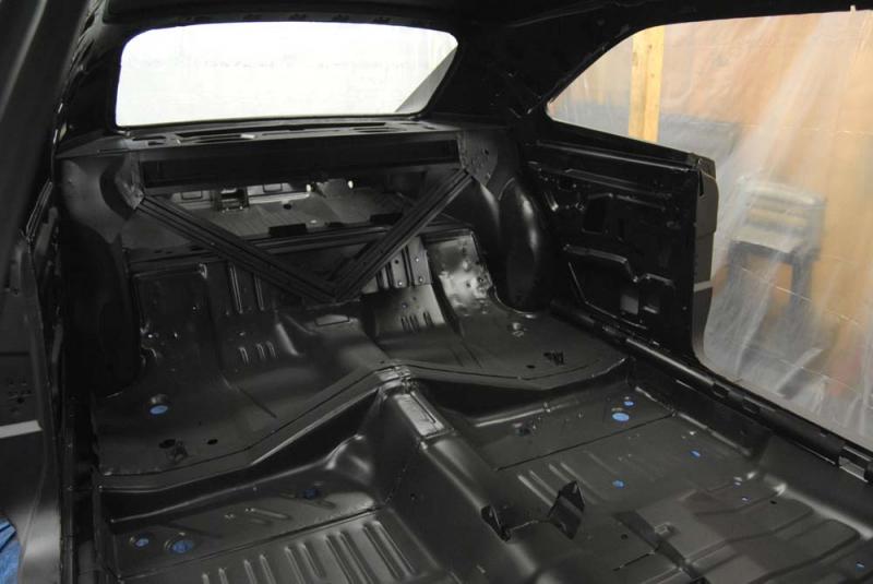

Hey gang. Well about a month since my last post and I’ve been busy getting the R/T ready for DP90 paint. It’s always the little stuff that takes all the time. All the welds are ground down with some nice and smooth. Others will need to be finished off with body filler due to running out of good weather to paint. The lead joints have a base coat of metal to metal. Seats fitted in for mounting bolt hole drilling along with the buddy seat brackets in place. Use a little magic to float the body off the dolly and onto jack stands. And then the big event…… PAINT!!!! All surfaces got a nice coat of DP90!!! Will go back over with one more coat on the whole car for good rust protection. DP90 will be the final paint on the underbody. I’ll hit the non-underbody with K-36 fill primer so I don’t have to re-scuff the car… again…. A couple of pics below for your viewing pleasure….
