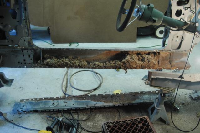

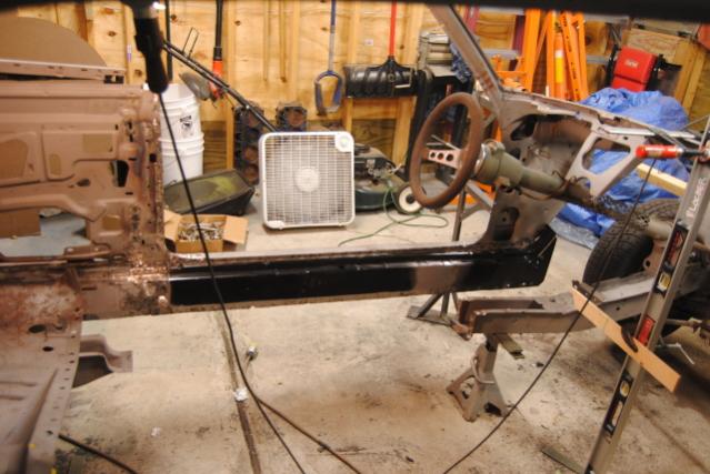

Thanks for the comments on the vacation pics and you are correct Matt. It was truly an amazing vacation. Now that I’m back to reality I was able to get my right rocker fully installed this weekend. Ended up replacing eh door jamb with one from a parts car I had due to the crappy body work of others. Sorry if I’m a broken record on the previous people’s body work but they did more damage than the rust did… :laughing6: A little more grinding to do but nice to have a solid straight right rocker. Hoping to start on the left side this week now that the weather is cooling of a bit here in SE MI. Only have to replace the front inner rocker and the door jamb on the left.

Thanks for the comments all. If you actually saw the quality of my welds you might change your mind about my skill level. :thinker: Getting better as a I go though. This week I finished removing the remnants of the torsion bar cross member, left door jamb (yup more work due to bad previous body work), and the left front inner rocker. Since there was a mouse nest in the right rocker of course there is one in the left. No mouse remains in this one. Looking for a new door jamb since the one from my parts car I saved is all rotten at the bottom (discovered after I cut it from the car). So I’m on a bit of a hold. Oh well, luckily the big Woodward Dream Cruise is next Saturday and it is at the end of my block. Many motorized distraction for the next week and I see little to no progress happing.

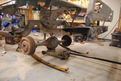

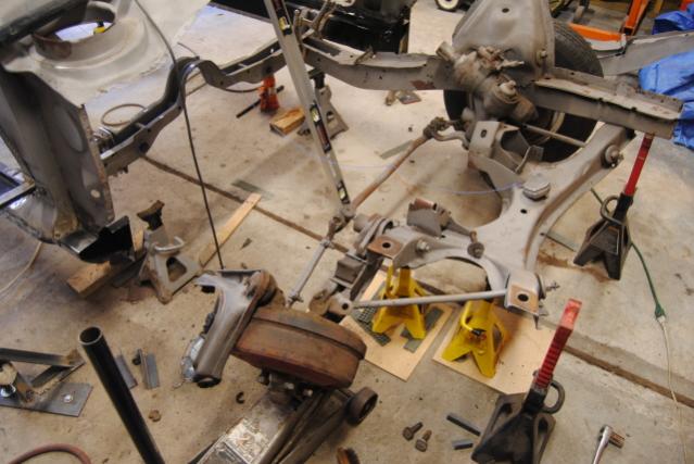

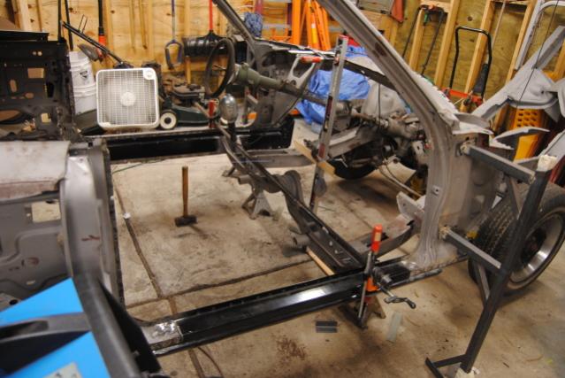

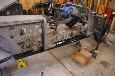

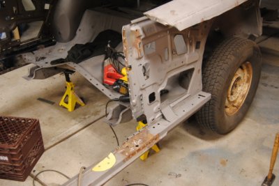

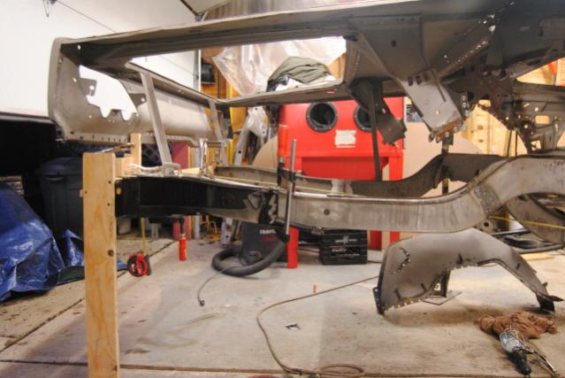

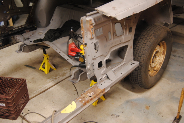

Thanks for the comments. Busy on the R/T recently. Replaced inner rocker and patched the outer rocker on the left side. Replaced the left door jamb. Installed the torsion bar cross member. Replaced both front frame rails. Removed back seat floor pan and both inner wheel wells. Partial replaced the right rear frame rail and replacement of the right rear spring mount. So just minor progress… :grin: Working on the partial replacement of the left rear frame rail and replacement of the left rear spring mount. Donny that measurement diagram has been really helpful!!! Thanks again! After the rear frame work is done I’ll be putting the rear end back in it, put the wheels back on it, and roll it outside for some sandblasting touch up since the car has been bare metal for 3 months now. After the touch up I’ll hit it with the DP90 epoxy primer before it cools off too much to paint. Then I’ll start working on the sheet metal for the fire wall, inner fenders, and radiator frame. Enjoy the pics!

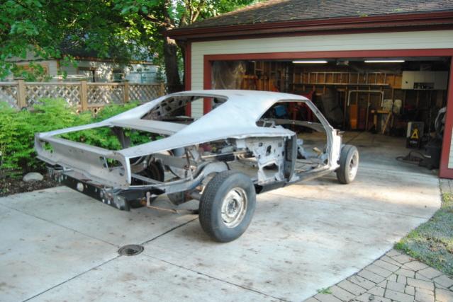

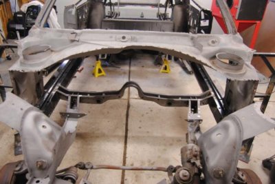

Thanks for the comments. Sometimes the faith is all that is getting me thru on this project.:th_krazy: Well after about 3 months on jack stands my R/T is standing on its own 4 tires!!! I finished up the frame work, installed the rear cross member, reinstalled the rear suspension, put the tires on, and did a looooooooooot of grinding since my last post. A few misc things to install before, weather permitting, I’ll do touch-up sand blasting. DP90 primer after that. Enjoy the pics.
