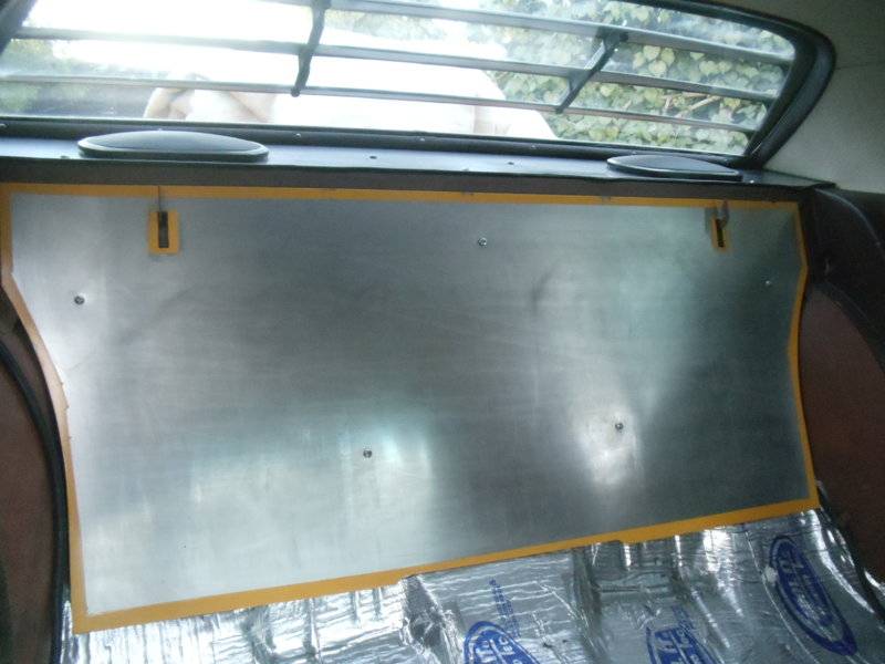

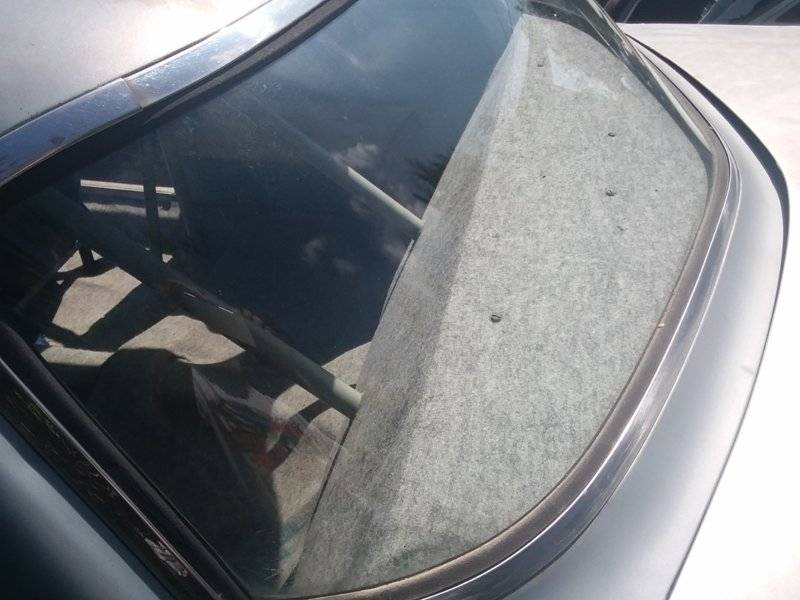

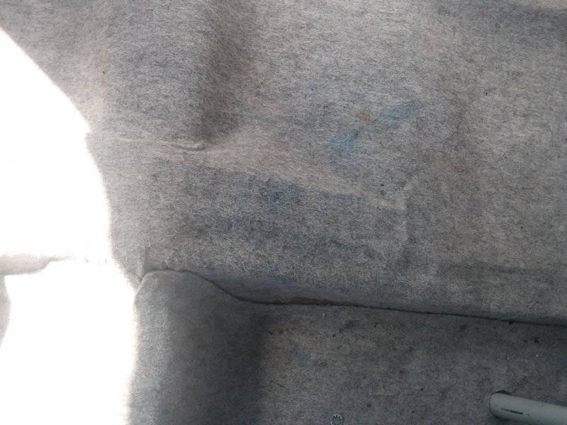

I put a roll bar thru the rear seatback area, so the seat had to go. The bars went just above the v shaped brace, thru a 1/16 aluminum panel required by nhra if the battery is in the trunk. Then carpet, from the back window , over the panel, cover the floor to the firewall.
I used the cheapest, thinest, lightest indoor/outdoor i could find. I think i got it from home depot. This was more than ten years ago, and i haven't seen it in the store in years.
If memory serves( and it frequently doesn't) total carpet weight was under ten pounds, with fiberglass buckets replacing the front bench, and back seat delete, i think i broke even on the weight of the bar.

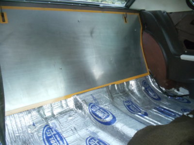

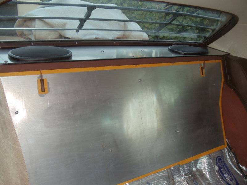

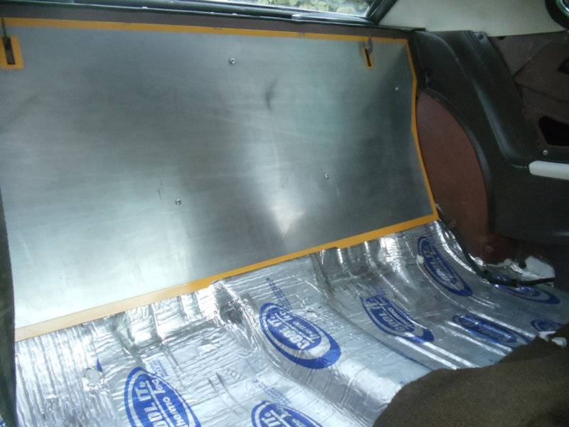

I can still put my seats back in anytime, rear shelf and trunk divider are now food grade stainless steel (vehicle can later be re-cycled into a kitchen sink).

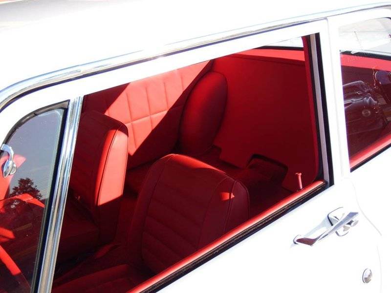

In my 65, I went with the A990 super stock interior with the rear seat delete. I used the delete kit and upholstered it to match the rest of the interior. I also have an aluminum trunk divider or bulkhead.
