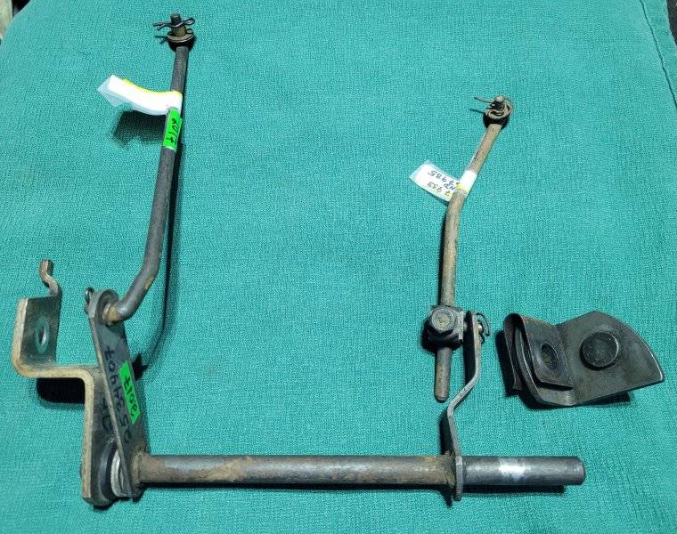

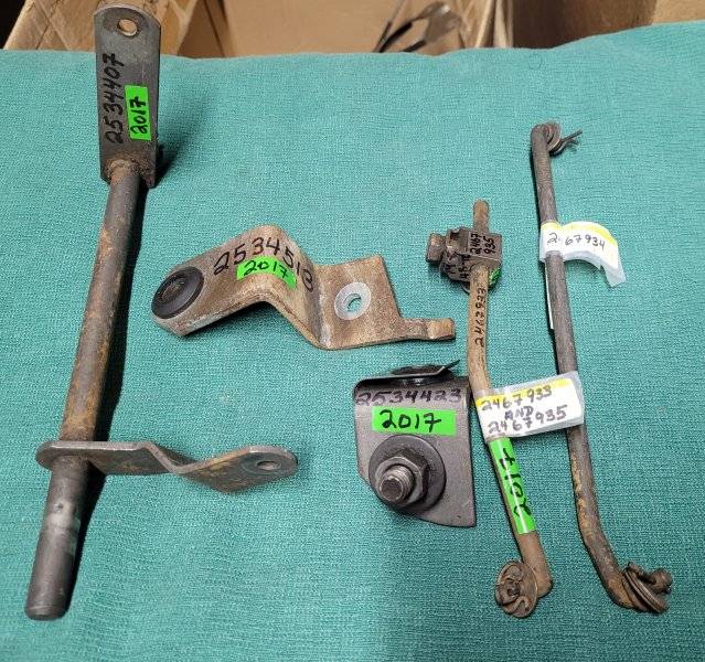

I have the column shifter linkage for sale. It was removed from a 66 Coronet 30+ yrs ago and put in dry storage. Part#'s were recorded on each part!
$200. including shipping in USA
