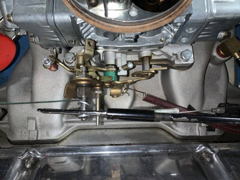

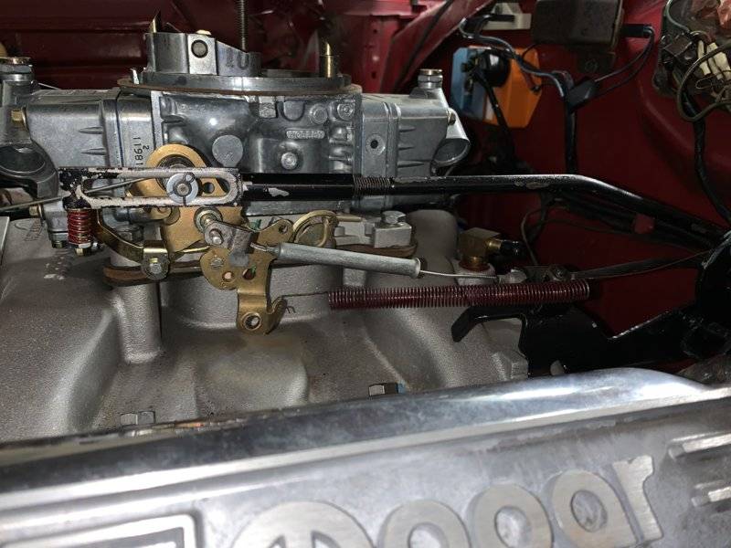

Thanks all for the input. After reading up on throttle linkage adjustment and looking at my set up, I got some questions concerns. See photos of my set up
-why is my throttle linkage and kickdown linkage on different on different throttle levers, shouldn’t they be on the same?
-return spring should be hooked up to throttle lever, but is hooked up to a different bracket on the carb.
-Holley calls for a throttle lever extension (P/N 20-7) if you are replacing a Holley carb. Obviously i do t have the extension, do I need it?
-looks to me that a I have an excessive gap in the kickdown linkage, does this look normal?

I'd say an award should be given to the person that set up your linkage! It seems every thing that could be wrong, is! You need the Holley/Mopar adapter. The throttle cable and KD link must be on the same pin, and throttle return spring also. There should be no gap showing between the pin and the slot in the KD adjuster and the adjuster needs a return spring.
Look at some of the engine pictures on this site and it will become clear to you.

Thanks, after looking at the repair manual and a few other setups vs mine, mine just doesn’t look right. Hopefully this is the culprit. Hopefully have some time today to mess with it.
Everyone calls it Kick Down linkage, me included. It's really Throttle Pressure Control linkage. It increases the hydraulic pressure inside trans. You want full pressure at WOT.
Looks like you might have found the culprit and also lucky you've not encountered binding throttle linkage. While it needs to be corrected, one of the checks (just for curiosity before disassembling) is to watch how the kick down is acting, or not as it should, with the way it's been setup, watching the action of the lever it's connected to on the trans with the engine off by opening the throttle all the way. The adjustment is to have the rod push the lever near to its complete travel (also not binding up by too much travel). There are some good videos on utube and can't recall the one I viewed; but the guys on it knew what they were doing with a late 60's RR. A matter of sifting thru those where some are for ****. My rough guess with this setup you have is the rod has little or looses its correct action on the lever. I'm no guru on this; just that I've messed around with this fixing effed up kick down adjustments a number of times; others here likely know more. Just my 2 cents.
