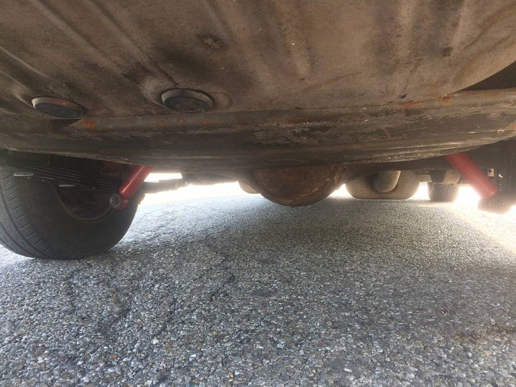

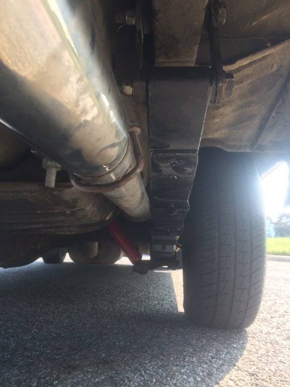

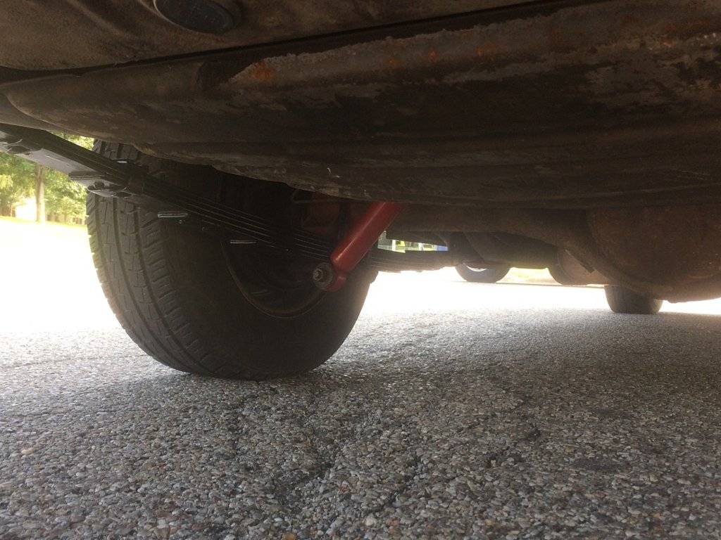

Well she's all settled in. The ESPO springs are amazing and make my MP XHDs feel wimpy. The Gabriel Imperial shocks fit like a glove and aren't harsh,The stock KYBs were about 1.5" too short at full extension,no lean from my Coronet. These springs and shocks coupled with the new 1 3/8 sway bar and KYB gas a justs on the front give a firm modern ride and still comfortable. Maybe there are adjustables in my future but Curren I'm very content. The only thing left are wheels and tires, the wheels are going to be cleaned up and sprayed gloss black with police caps. Probably Futura GLS' with the letters turned in, the rear.(255/70/15) and some MT sportsman in the front with letters turned in. (225/70/15)
