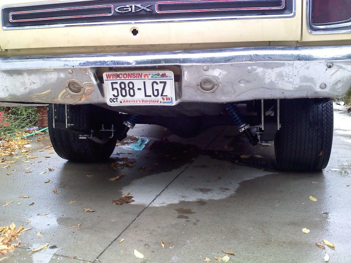

if your just looking to jack up the rear of the car go to your local autozone or whatever your parts store is and ask if they have any type of leaf spring lift kits or longer drop shackles i got these from autozone for i think about $40
Hmm Thanks! That's pretty cool. So i could have to about normal height but when i go to a show or something i can raise it. Never seen those... Now do they seem sturdy? Also now those who said to ditch the air shocks unless it's built to hold the weight? I was looking under there today and i just don't know what i am suppose to see... But that lift spring kit might work...
This I wouldn't recommend,
no offense, it just wouln't handle very well.
This I wouldn't recommend.
Ditto. it makes a cool car look cheap.
Air shocks and shackles went out in the early 80's.
If your going for the old school look, HD springs from summit racing will raise your car up, Not 3", but anything too high, your handling and tracken goes to crap.
