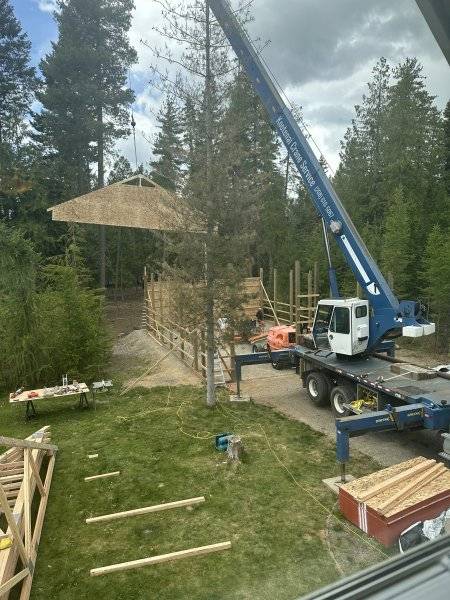

Boom! And just like that……trusses! 2 sections of purlins to go.

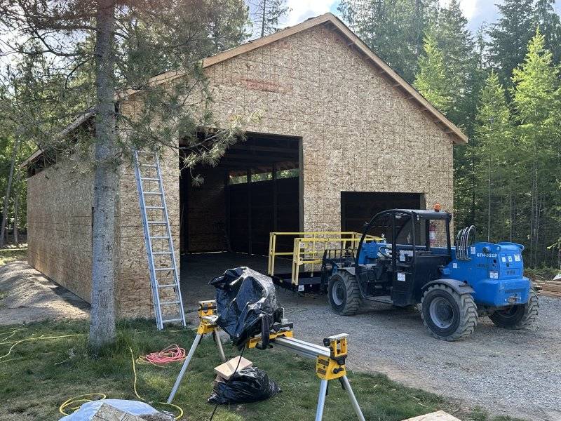

Framing and sheeting about done. Metal next week! Remembering with my first shop how nice it was to work on a car with everything laid out nice. And not having to play garage Tetris to get to everything! This one will be even better!
Why sheeting on a post frame build, I know it’s stronger and will hold better, is it required in your area?
Strength and to eliminate “rain” inside due to condensation. In the county here, the only inspections required are electrical and plumbing. Otherwise it’s the Wild West, especially on barns. The guy heading this effort is a Master Builder from Atlanta, he’s not shy about putting extra lumber where it counts and being precise on square and measurements . This thing is solid!
