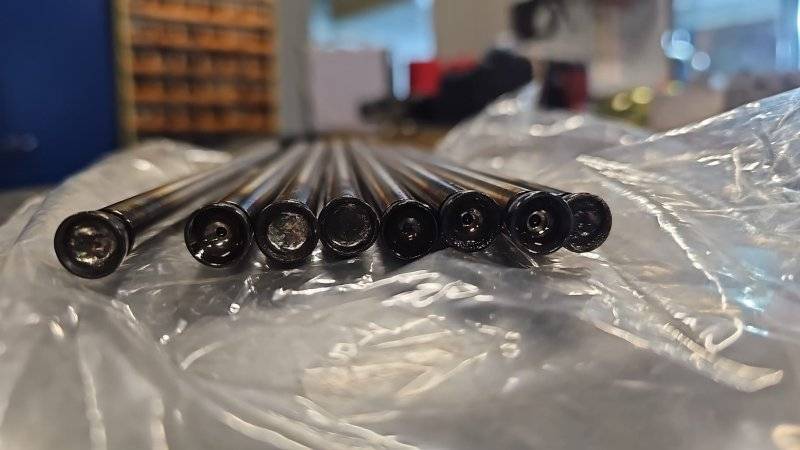

Hi everyone! I just found some issiues with my new valvetrain and looking for the cause of it… have anyone seen this? It has only a few minutes of run time (less than 1h) new cam, new lifters, new harland sharp rockers. Two of the adjusters on right bank are shot and four on the left and the pushrods aswell. I have ordern new adjusters and all new pushrods… i had the lash pretty rough adjusted on startup and then adjusted when it got hot. But maybe they where gone before it got hot due to rough lash or not enough lube at startup? What do you experts think? (Cam and lifters, valves are unharmed)

The pushrods are smith brothers 3/8s and 0.080 thickness with 5/16 cup. I’ve been running them for 5 years no problems with ductile iron rockers. Just changed to Harland Sharp rollers and this heppened. Yes i pre lubed the engine while it was on engine stand without covers to verify there was oil to the rockers on both sides.

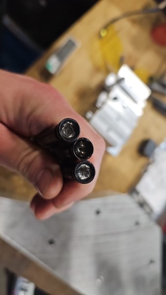

The pics look like soft metal to me, or wrong radius.

They should be at least file hard. See if a file will cut them easily.
I'll assume the following; The cam bearing holes are lined up so oil is getting to the shafts. The shafts are installed with the oil holes down in the correct location. The adjuster ball/pushrod cup were the same size. The adjustment/pushrod length is correct allowing the adjuster 2 threads out of the rocker. If so oil should be flowing from the hole under the rocker tip to the adjuster/pushrod cup. I've seen plenty of racecar rockers come loose when they weren't lashed correctly. Haven't seen this kind of damage unless the pushrod fell off the rocker. What do the adjusters look like? I'd be on the phone with Smith Brothers and Harland Sharp.

Don’t mind the discoloration of the cup that was from 5years ago when we had them made

The adjusters are about 2 threads out, adjuaters and cups are 5/16. Cambearings are the same since total engine build 5 years ago and it came oil thru the rockers on both sides when i primed the engine while spinning the engine by hand. The biggest problem is that i live in Sweden so getting intouch with suppliers is a pita. But i’ll send them some e-mails and hope for some good advice
I agree those look like they were not hardened correctly. My harlan sharp rockers have been fine, but I bought them around 20 years ago.
