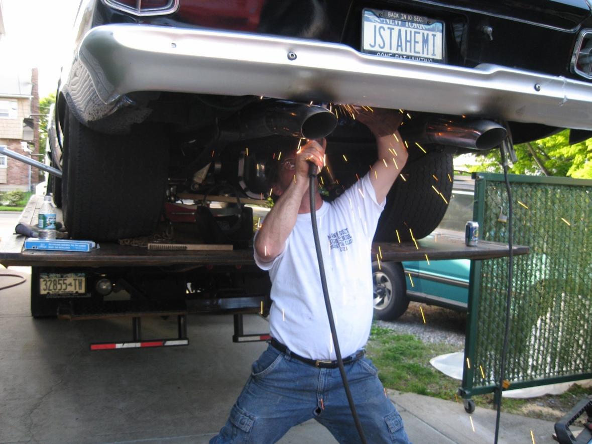

This needs to be answered first:frozen tongue: Gotta have tailpipes!!:hehe::icon_rolleyes:
