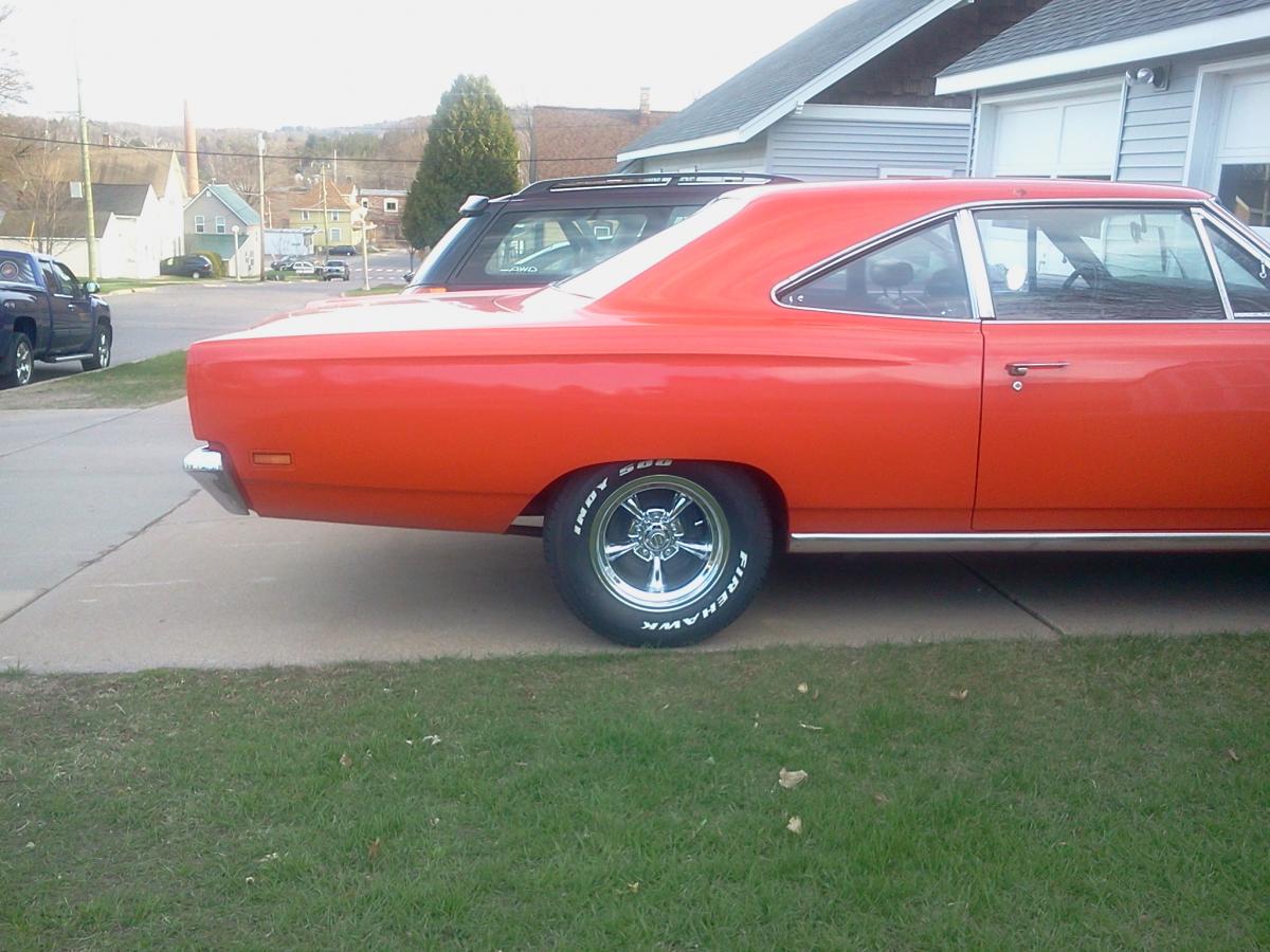

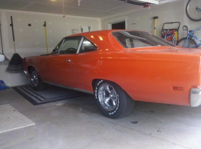

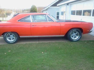

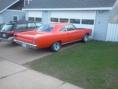

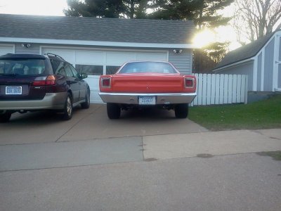

Well after much internal debate back and forth with myself, I did persuade myself into the 8.5 on the rear. I did it because I didn't want the tires to have a ballooned look. I wanted the sidewalls to be as vertical as possible. I also went with a 255/60 on the back. I think it was a 10.5 treadwidth. I went with 7's on the front with a 70 series. 225/70. I'm real happy with the way it came out. I think I might have to pick up the *** a little to gain some rear fender room. I believe they were a -24 offset on the back. I'll try to post some pics with the new shoes.
here they are
Wow, if you don't post pics very often you can easily forget how to do it. As you can see the rear needs to come up just a hair (maybe a half an inch) and the front will be coming down some as soon as the new front end kit goes in. My dash is torn apart waiting for a tach from year one that will accommodate an electronic ignition and waiting for the new sound system.

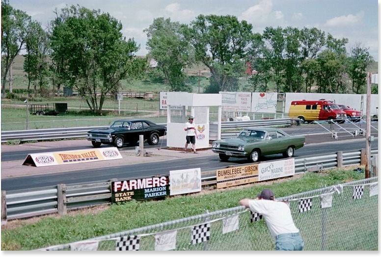

WOW!!! What a difference. I wonder how many dragstrips are called "Thunder Valley"?
