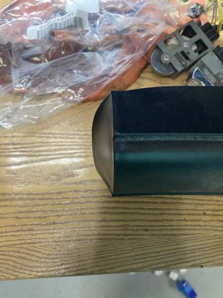

After finally finding center dash pad for ac rally dash - 69 Super Bee- I have also obtained an additional glove box door that came with it. Both it and the one I have seem to have shrunk on the face of them, leaving an angle and a gap that doesn’t look that great to me when installed.
Anyone have a fix for this, perhaps gently heat up and re-mold somehow? I’d like to try to fix before I paint it.

usually the pads pull apart from interior part of frame. I pulled it apart added 2 part epoxy and clamped together and pretty much looks perfect. If you can find originals you will be much happier, I changed out all my reproduction ones to original because of the reproduction material looks like ****. JMO
