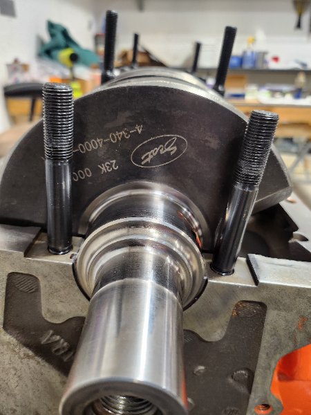

currently putting together a rotating assembly, On the 3-4 rod journal on the crank I'm getting .030 between the rods. rest are within stock spec. Stock dimensions spec between .0060 and .014. Called the balancing/stroker kit guys I purchased it from, they say up to .040 is acceptable for aftermarket assemblies. Sounds like a way to make me go away for now, not sure. Would hate to completely assemble this and have an issue. Any engine builder guys have any thoughts on this, thanks for your time.

We ran into that years ago and was told don't worry about it. I do not remember the numbers but about twice as much as the factory specs.
I have conflicting answers here talking to some friends also, I was also wondering about the rod bearing clearances effecting the pressure more so than a sloppy cut on the journal, since its basically a thumb over the garden hose thing, if you get my meaning.
Aftermarket rods lack the holes that spray oil up towards the cylinders and cam. Therefore,more side clearance is probably good to sling more oil in that general direction.
It has to squeeze through. 002 - first. Then just bleeds out the side gap regardless of size.
This topic bubbles to the top again every so often.
Before all the aftermarket cranks and rods showed up it was common to run BB Chevy width on a Mopar crank turned down to Chevy diameter. The Chevy width .995" vs Mopar 1.007". you can see that added roughly .024" to whatever the clearance was going to be to start with stock rods. Did it bother anything? No. the restriction in oil flow is the rod bearing area which is far smaller than any normal side clearnce figure. Many current high end race engines run piston guided rods with huge side cleaance. There are plenty of items that need scrutiny in a good build. Extra side clearance isn't one of them.
Doug
Sounds like the crank grinder caused the problem if you have 3 in spec. That one journal may well be wider. Conrod widths (assuming they are a matched set) usually within a thousands or maybe 2 at most.
You cannot do much about too much side clearance.
The wider rod side clearance will not be a problem. Just check they cannot rub on the piston boss and run in the middle of the wrist pin.
Thanks to all, In the past I have had the rotating assembly done and I finish the rest but, Hard to find someone that's competent, being the older guys retiring etc. The price of parts are nuts and a rebuild, especially a modified one is a major investment. I'll have over alot into this and just freaked out by something being this far off. thanks again for all the info.
