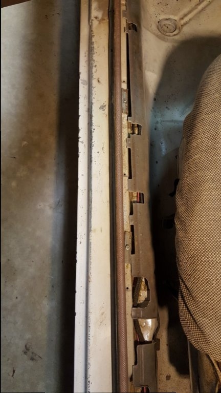

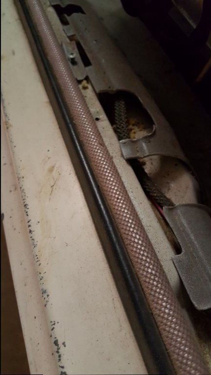

Here's my 62s, No holes for an outer. It's also showing the wiring harness shield.
You don't have to use an outer sill plate if there's no holes for it. Or you can use an outer one and drill your own holes.
Is that some kind of seal or wind lace over the pinch weld next to the wiring harness shield?
