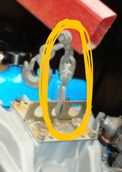

Not a big fan of the redneck log chain method tearing up the fresh block paint.

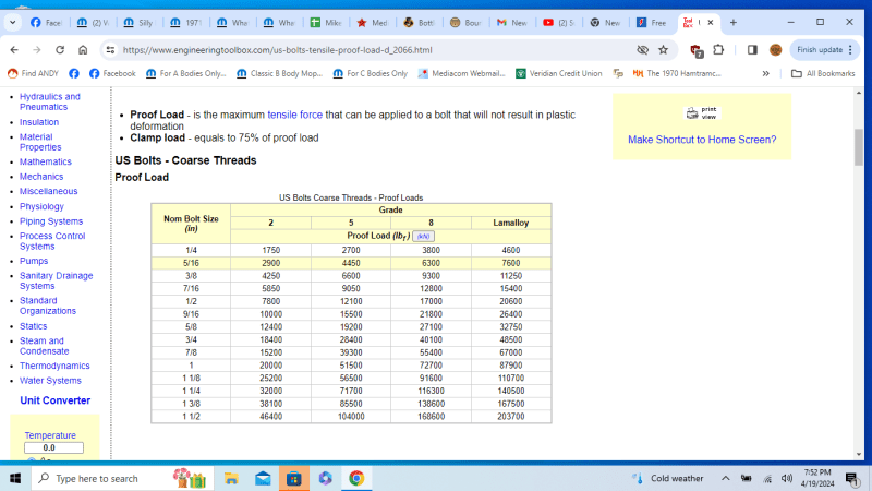

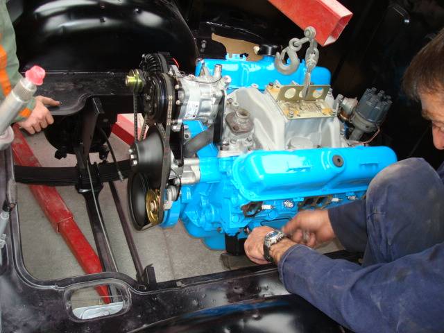

Hard to believe a 5/16 bolt has that much strength. Multiply that by 4 and you have enough to lift a 800# engine.We've all used some version of the engine lift plate --- the one you bolt to the intake manifold for the engine lift. Every time I do this I get the willies because it's just 4 tiny bolts in an aluminum intake meant to hold a carburetor.

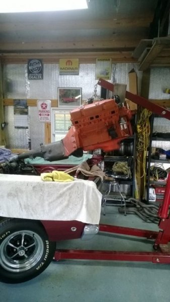

How much weight is reasonable? I get it... "an engine"... would you be comfortable ranking and engine and tranny with it? I'm just curious.
I have other lifting devices, but they can be a pain... and the plate is easy. But it makes me nervious for some reason.

I hope this thread makes it to at least ten pages....as it seems the tensile strength of a Grade 5 bolt is increasing with every post....Tensile strength of a regular Grade 5 x 5/16 bolt is spec'd at 6300 lbs.

Everyone looks to be scared of that plate. I see trembling hands.
That looks like a cherry picker, not an engine hoist.
And at least one person passed some wee'sEveryone looks to be scared of that plate. I see trembling hands.
