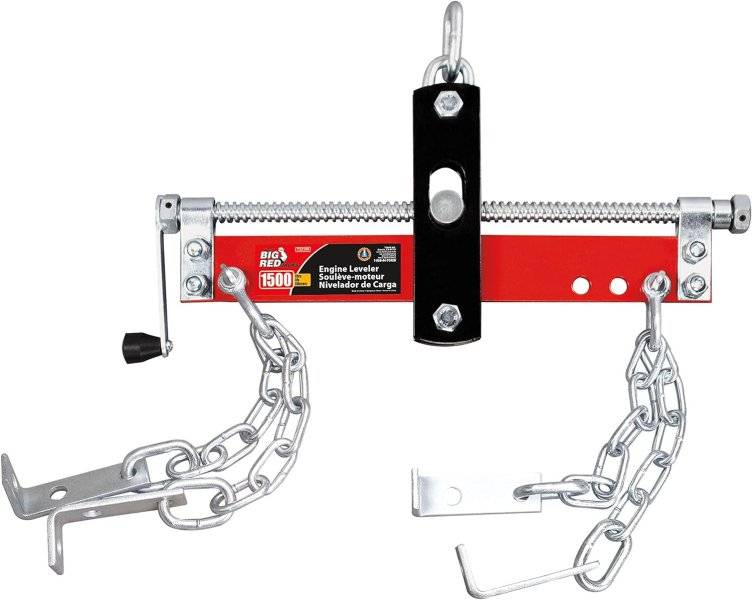

I bought an engine cradle that I can crank the balance and thus the angle of the engine as I need to
like this only Red

From the first engine/trans I pulled, I've always used a leveler. For $30 why use anything else? I've pulled numerous engine/trans without scratching the paint, easy to do by yourself too.
https://www.amazon.com/Torin-Engine...fXcTRbAPUD7H0IQgDBk2OAWm8FRoCuGMQAvD_BwE&th=1

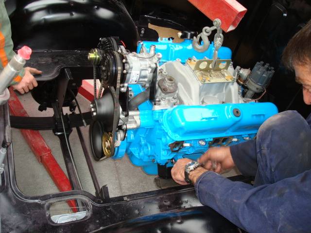

Have one and used it a few times but learned where to place the hook on a lifting chain and then stick a big screw driver in a link to keep the hook from slipping. Been doing that since my first engine pull in 1970.

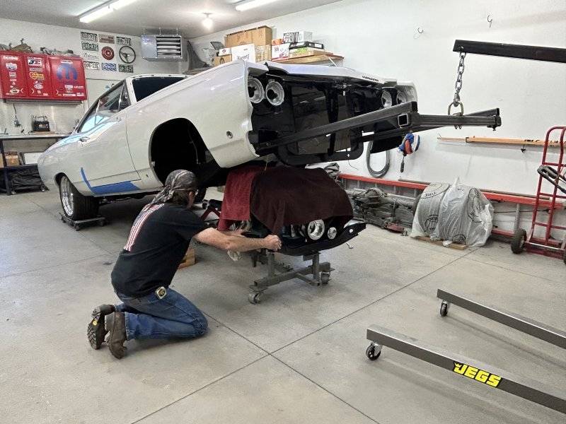

Had a cherry picker.....don't particularly care for them especially with a car that rolls. My shop has two areas up in the rafters to hang a chain hoist and one up front stays in place. The other one in the rear of the shop hooks up to a wood cradle that sits on two joists. Down side to a chain hoist is the pull chain. One hoist has a shortened pull on it and it doesn't get in the way. And a cherry picker takes up too much room in an already crowded shop.

Not a big fan of the redneck log chain method tearing up the fresh block paint.
Not hard to keep the chain from tearing up fresh paint.....and a logging chain is huge. A 1/4" wide link chain is more than enough.
