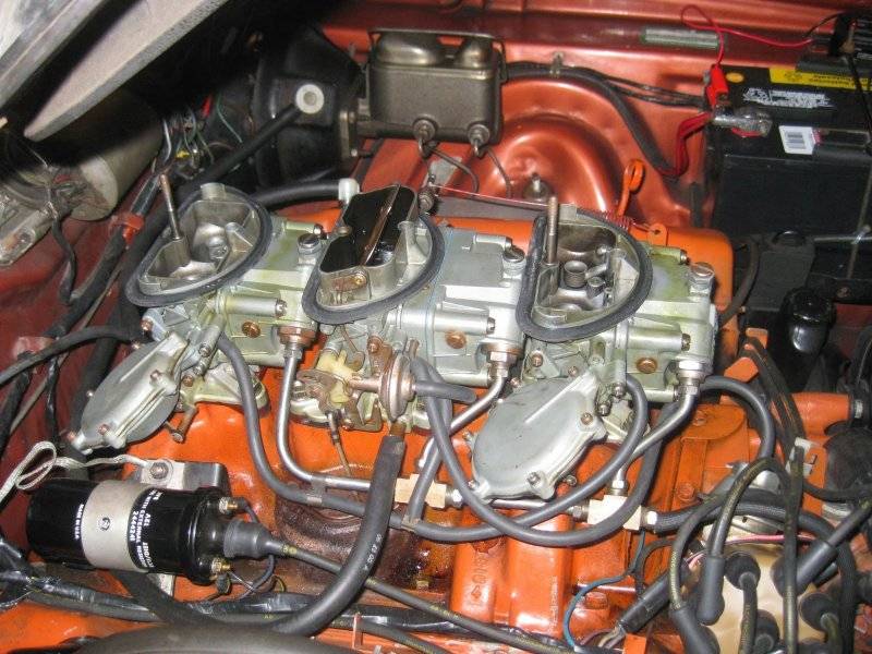

1970 440 six barrell. I needed to take the center carb off last nite. Of course one of the fuel inlets was turning when I was removing the fuel line. It's tough to get a wrench solidly on the inlet. Does Holley or someone make a tool for that occasion.

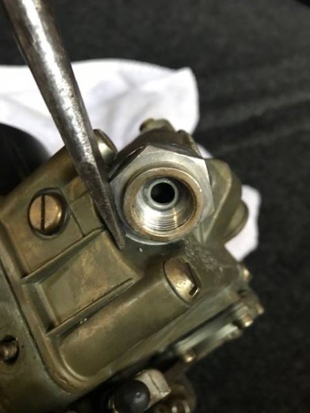

I've always been able to remove the center carb without any difficulties...BUT... proper tools sre required. ABSOLUTELY USE A FLARE NUT WRENCH (on the tubing nut).....AND a 11/16" (MAC TOOLS) 4 sided open end wrench....its thin enough to fit the Holley hex head fuel bowl inlet fitting, without rounding off the corners. ALWAYS replace the fiber gasket under the bowl inlet fitting and DO NOT OVER TIGHTEN....bowl threads are delicate.......and....when reassembling, back up the bowl fitting with the 11/16" wrench when tightening the fuel line nut....with a FLARE NUT WRENCH......use NO tape or thread dope on the flsred connection.....assembly dry....in spite of what others profess......just my opinion of course......

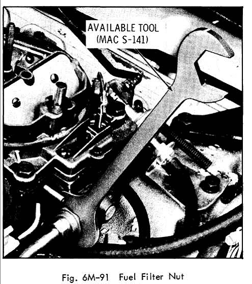

Do you have a Mac tools part number for that 11/16 wrench?
The S-141 comes up blank on a search at MAC.
Maybe(?)......................

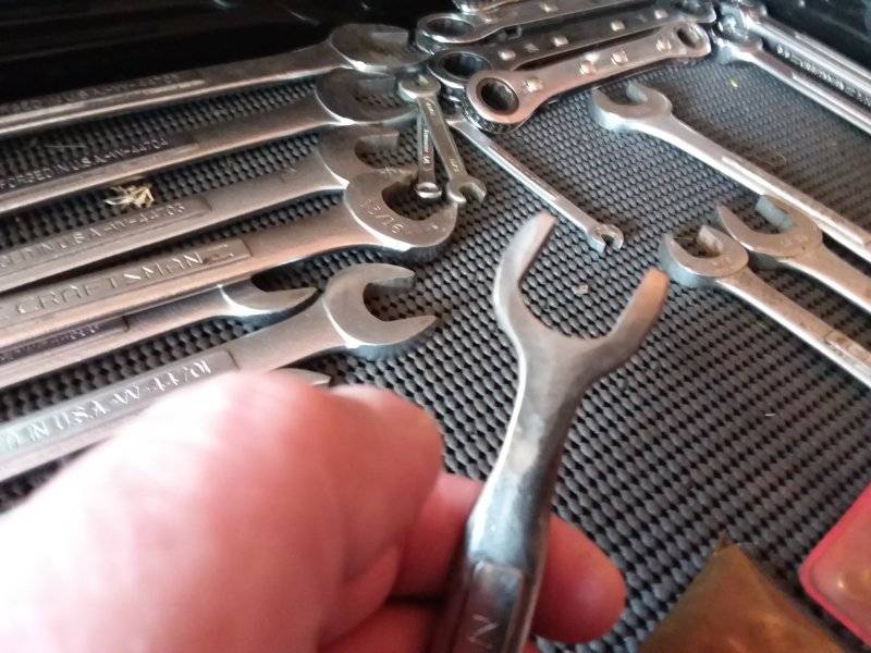

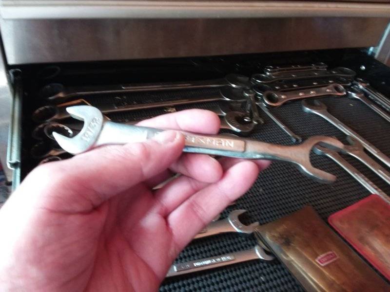

I just took an old regular wrench and ground it down flatter and thinner so that it fit works perfectly
Pics of my tool, works great.
