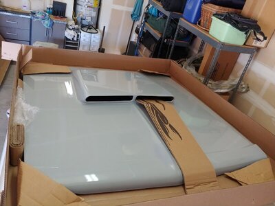

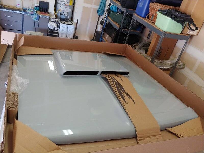

Got the hood from AAR/Stinger. The hood is beautiful. The top side is smooth as glass (no pun intended); just needs a light sanding before primer and top coat.

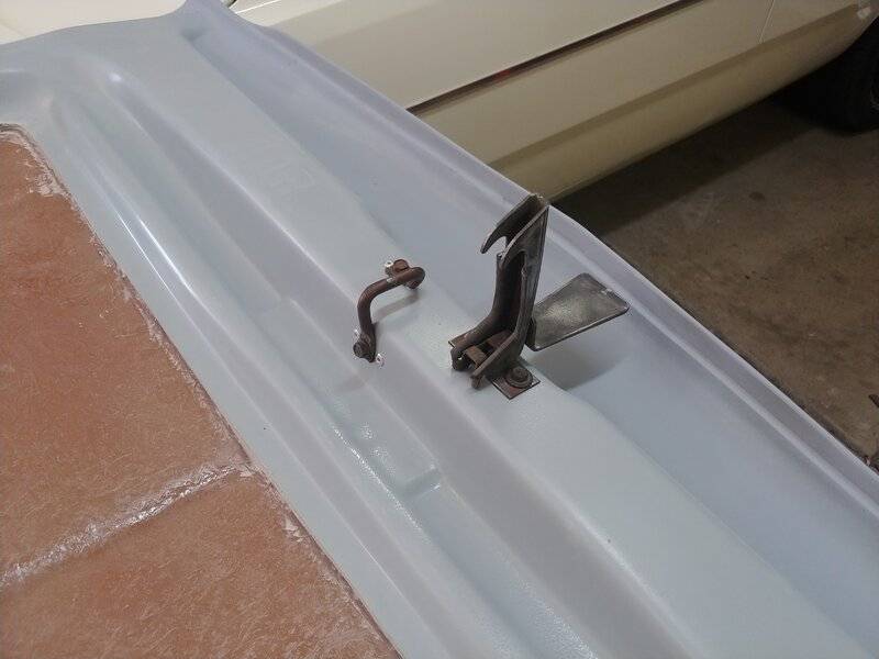

I also bought a hinged 6 pack hood from AAR last month and am 95% happy. Great customer service, delivered as promised, fit and finish was good, was able to get good gaps on all three sides. Will have to fiddle with making a new loop that goes into the hood striker as they drilled and tapped a hole for that slightly off.

This is what I was talking about in terms of having a hole drilled slightly off.

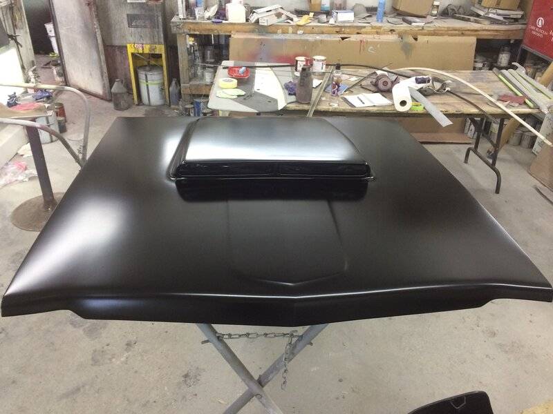

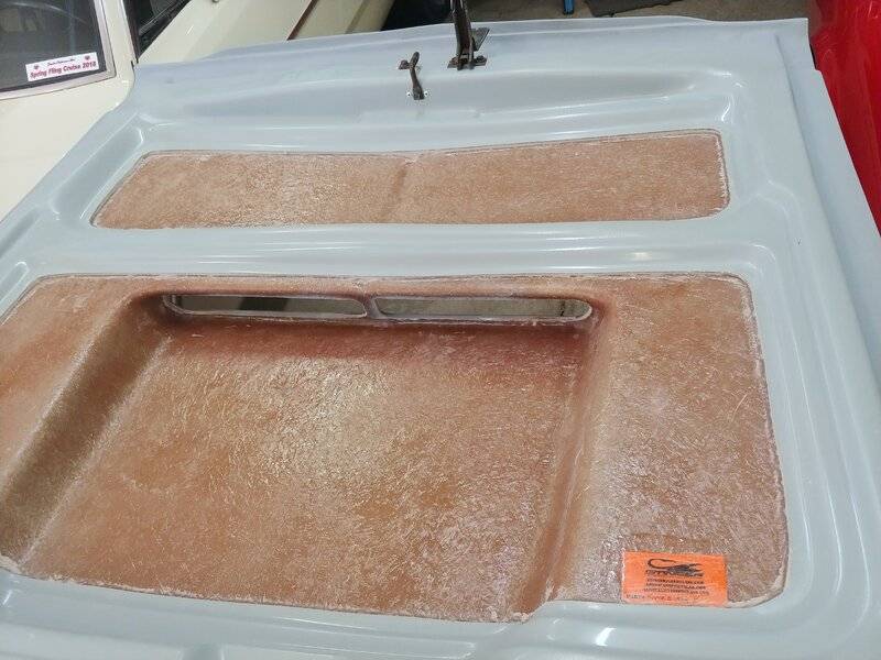

My body shop guy was fast! Dropped off Tuesday and it’s done today. He other black stuff to do I guess.

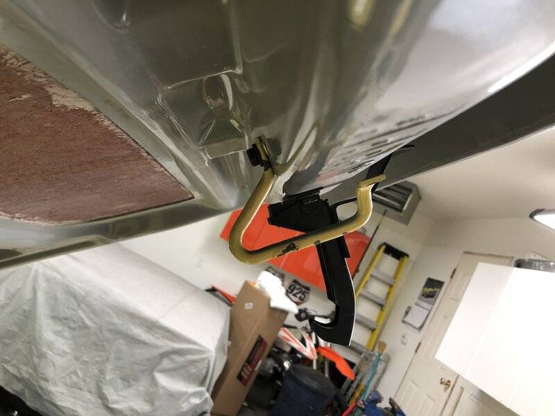

I'm test fitting it this weekend. I also got the hinged hood so I'll be sure to measure up the loop and the latch.

Busy weekend so I didn't do much on the car, but I wanted to see how the hood latch and hoop lined up. Turns out it was a perfect fit.

Ouch $1500? I think that's too high for just a fiberglass hood, and yours appears to need very minimal prep. I'd keep searching and try to find someone that wasn't necessarily the "classic car resto shop' type of place.

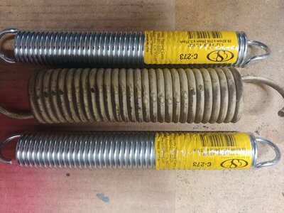

Picked up the springs today at a hardware store, C-273. Ironically if you go on CSC's website and search for the part number nothing comes up; you have to Google it.
I had a pair of old hinges laying in the garage so I tried removing the original spring. It's not too hard, put the hinge in a vice and using two stout screwdrivers I was able to pry one of the hooks off the hinge. Now for the obvious statement: do not attempt to remove the springs while the hinges are on the car. Something will dent or break.
Comparison of the 273's against OEM:

Edit. Those new springs are stouter looking than i thought they would be. Hope they work good for you.
