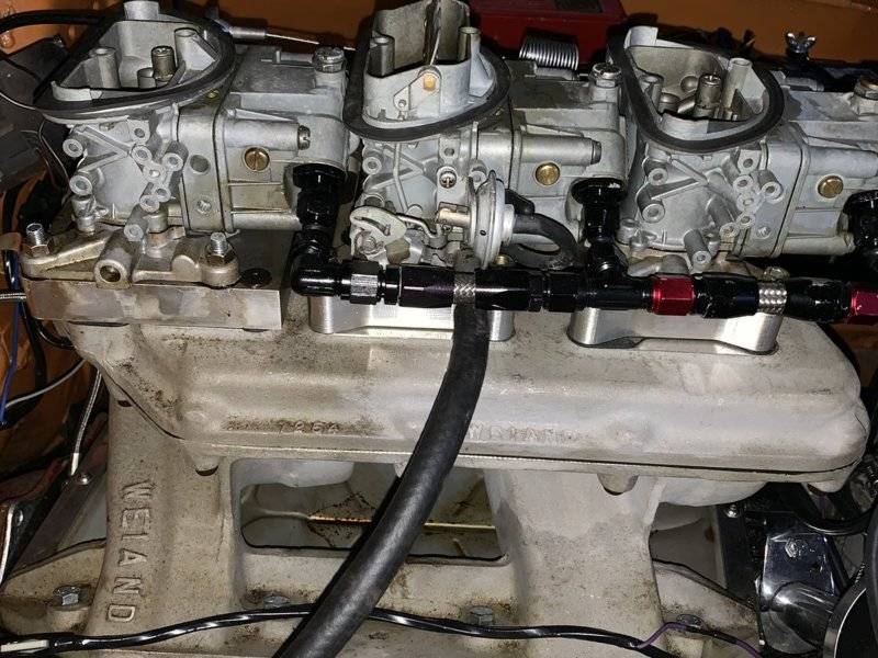

Center hung bowls will not work because of the rear carb. I think the fuel line entrance on the front carb is the issue with a stock air cleaner. I run a A12 base on mine and it works fine cause it’s flat. I’m sure the fuel line issue can be worked around though.

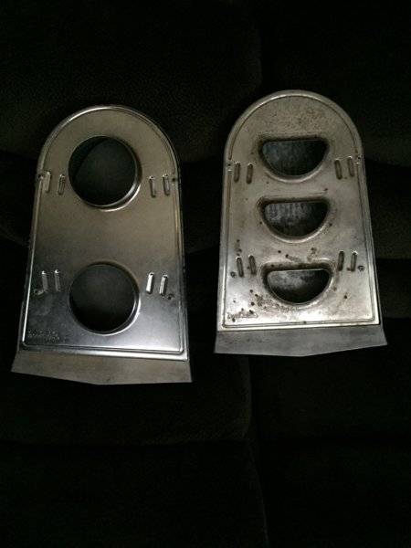

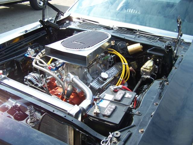

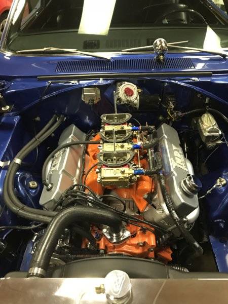

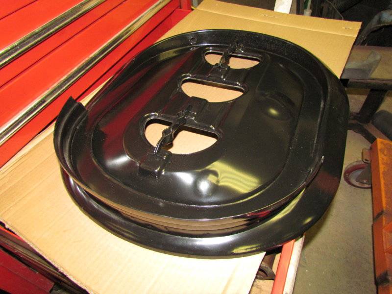

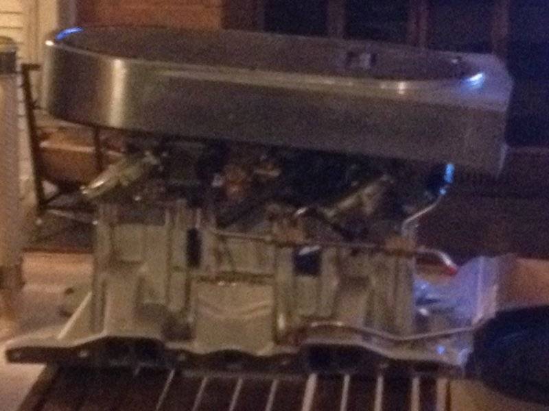

I do them all the time, I make my own front fitting or I run the line out back or run 3 separate lines like 68 HEMI GTX. I use a stock 440 6 pack air cleaner but you have to put a dent in it for the front fitting to clear. I know I have a picture of a air cleaner but cant find it at the moment.
found the picture of the base, some thing like this and it will work. This is a reproduction base

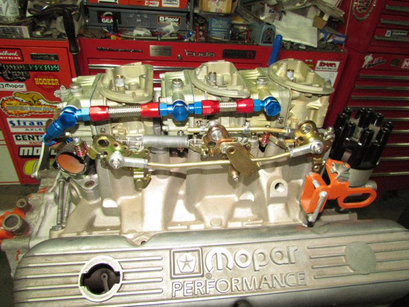

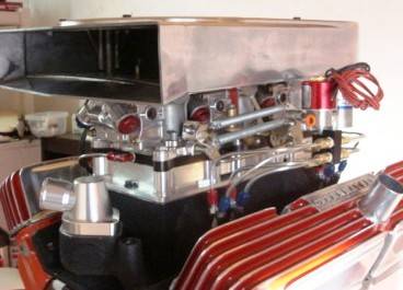

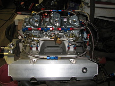

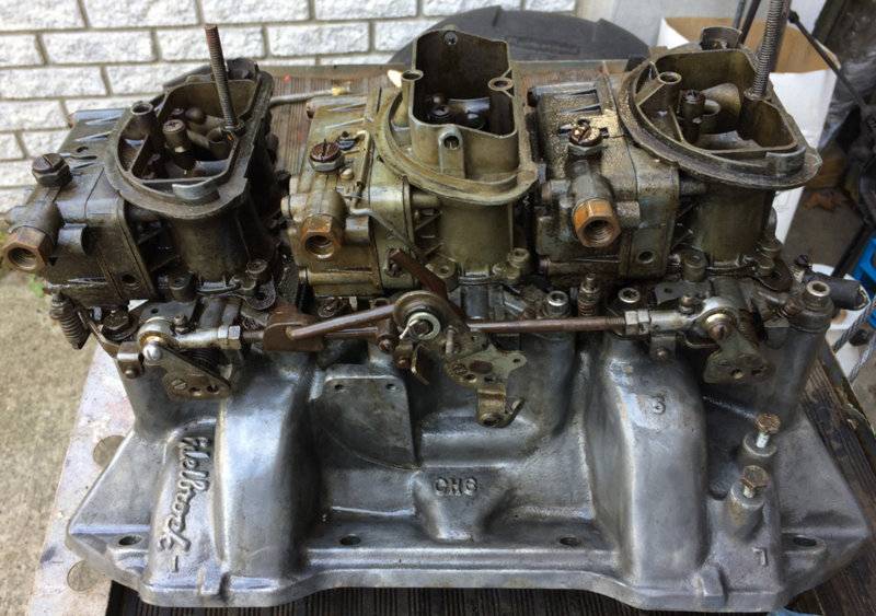

Take a look at this. He has mechanical carbs with center hung floats. Upon further inspection he fabricated an offset for the rear carb! wild! Cant use stock aircleaner now
