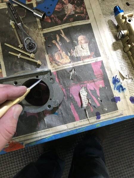

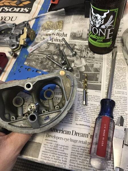

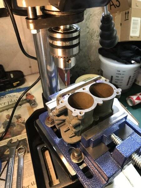

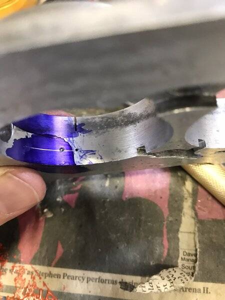

I also did a ton of work on my mechanical outboards. They have unadjustable idle circuits out of the box. I found them to be lean on my 511 so I added adjustable idle circuits and adjustable IAB’s as well. I run a 4412 as a center instead of the tiny stock carb.
