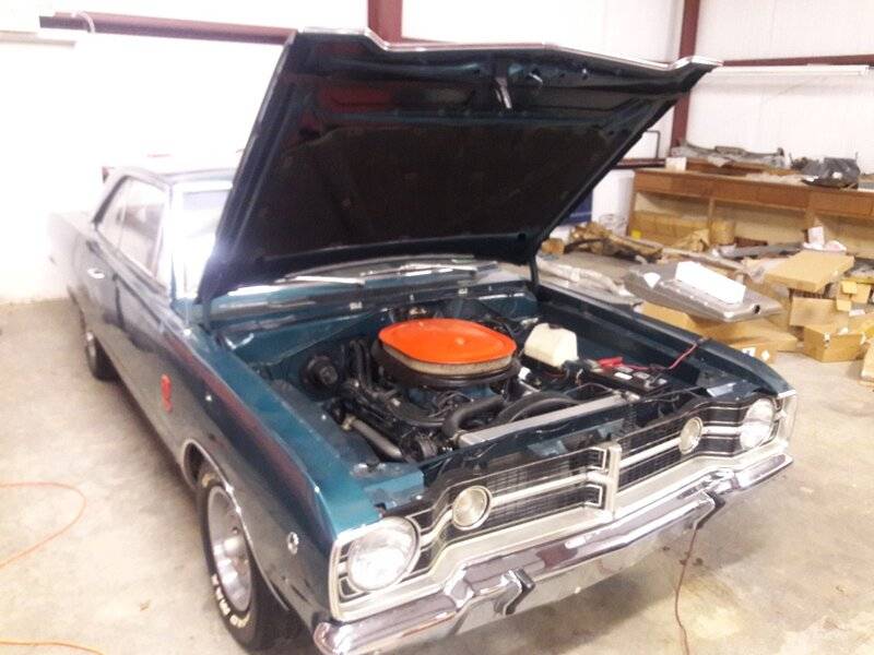

FWIW, It fits in my '69 Barracuda. No carb spacers, no hood pad, but no bracing removed. Air cleaner super tight to the hood at the distributor area due to the driveline offset.
Don't install air cleaner studs until you know how much clearance you have.
It fits on a A body, why not a B body???

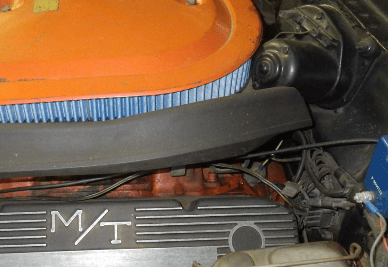

i had a six pack on my old 69 road runner with a stock hood fit perfect but you got to have three speed wipers for air cleaner to fit
And to someone who might not know much about Mopars, that comment can make absolutely no sense :lol:
Yeah, those two speeds are a little close on the Barracuda as well......
the 3-speed wiper motor sits sideways and provides the necessary clearance for the 6-pack baseplate.
And yes, it all fits under a stock hood.
Thanks for the explanation of the wiper difference and the confirmation of the sixpack fit.
